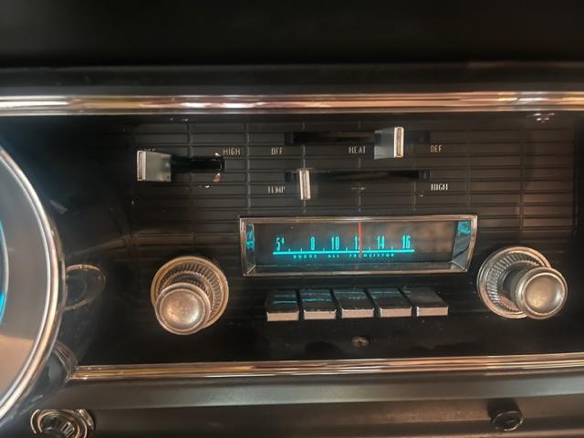

I want to thank Skatpak (Todd's Restorations) for servicing my power pak for my 67 Dodge Charger and for taking the time ( on a Sunday afternoon) to stay on the phone with me as I trouble-shot my dash wiring, while I was under the dash! His patience and knowledge is invaluable to any Forum member. I was able to trouble shoot my wiring to find that my power pak was not getting the power from the fuse box, which lead us to the headlight switch , terminal H(tan wire). My thanks to Skatpak to talk me thoguh the process of elimination to find the source of my problem. I would recommend Todd's Restorations to any Mopar member in need of certain repairs but especially the 66-67 Electroluminescent lighting. I have posted a photo of my EL lighting at the end of my phone calls with Todd this past Sunday. Thank you
