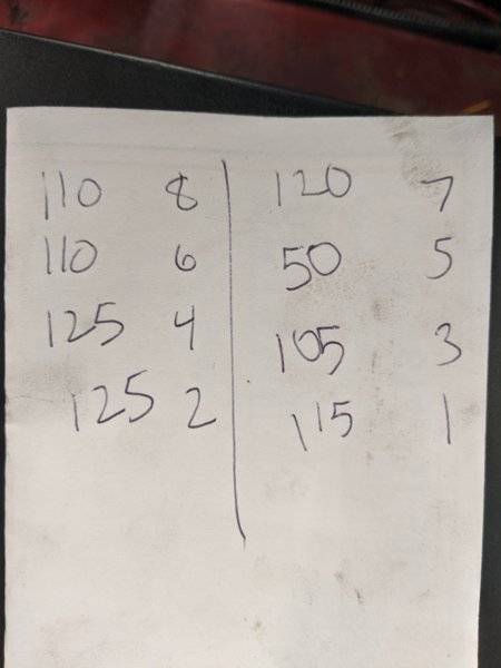

I had exhaust leaks anyway so I just took the HP manifolds off. Life got much easier then. But the test didn't give me good news.
Put some oil in #5 and test again. If it stays low you may be able to get away with re-working the heads.
If it comes up...
Well then you are in for a rebuild.
Unfortunate. The "better" numbers are bad, and the bad number is worse.
If it comes up...
I forgot to say. I did the oil trick and it didn't come up. I'll be removing the heads once I get back in town and taking them to a shop. Or buying a cheap 440 on CL and taking my chances. Can't go wrong with more displacement.
