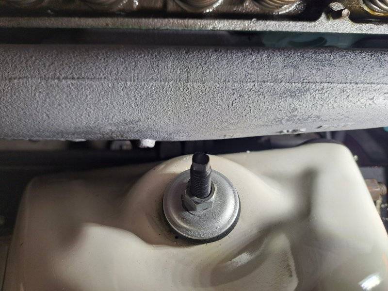

Need a little input from you guy's. Replacing the Teflon seals in the 426-S with Viton. The Teflon seals were installed during the build 2002 way before my ownership. Due to the shock tower being so close I'm finding it difficult to start the compression hose fitting into #4 & #6 plug holes. Standard length Snap-On hose from my kit. A 90 degree adapter would be great hooking the air hose up under car. What have you guy's done in this situation? Replacing seals or just getting compression readings? Thanks!

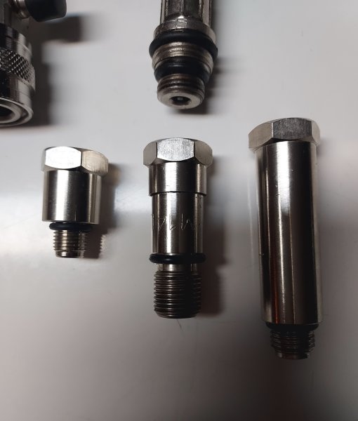

I've done compression test on my 440 in the '62 and don't remember really having that much trouble. I do have headers and my tester has a plug fitting that screws in first like a spark plug then you attach the hose. I know #4 is almost easier to install the plug from underneath.
Do you have a pic of that "plug fitting"?
Tried that on both...
I use a short crimp hose like this.

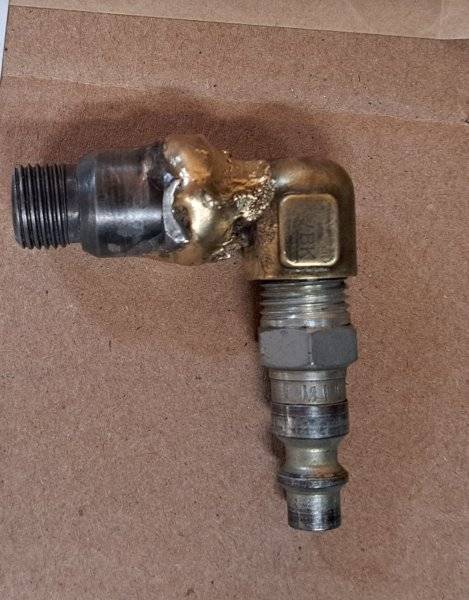

I thought about cutting off the insulator of one of the old plugs, drill and tap or weld a 90 to it. Whadda you think? Or maybe one of those non oil foul adapters? which ever would be shorter.
Like this.....just thread in a 90 degree fitting with 1/4" female end then screw in air fitting...

Gonna try one of those Dorman antil oil foul adapter with a 90 degree fitting. Will report back with my findings. Thanks guy's!
That hose by itself from underneath you should be able to get it in the hole.
