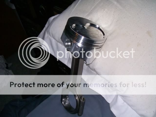

This is the I-beam rod and piston I run from 440Source as they came with my 4.15 stroker kit. I bought thses in early 2011 as I had the eng in the car running in June 2011. They are still working great for me and have held up fine. Ron
that looks like a PEP rod and Icon piston.

I can tell you the 440Source I-beam rod I showed you is the rods that came in the 440Source 4.15 stroker kit I bought in 2011 and one reason I had no problem using them was because my brother was using them in his 499 stroker and he had them in his buddies 493 he built for him. Myself I like that rod as its held up great in his race eng and his buddies street eng. The only thing I saw on them was the piston pins are a tad tight which was no problem to me as I just honed the rod bushing to get the pin fit I liked.
I cant say if they still use the same rods in their kits now but everything in the 440Source kit I got was fine to use in my street eng. I did work a few items a tad but everything came in specs and as I say its been holding up good. I race the car once or twice a year so I put about 4 to 10 passes a year on the eng but I drive it a ton on the street. I do not street race but I will wind it out a little every now and then but most street miles are easy driving. It does get alot of street miles on it though. Ron
