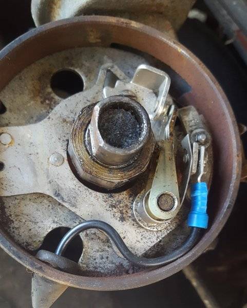

First pic is distributor in the 325.
The important question is should the points just be hanging out on the opposite side of where the condenser screws on with the coil wire?
My guess is no.

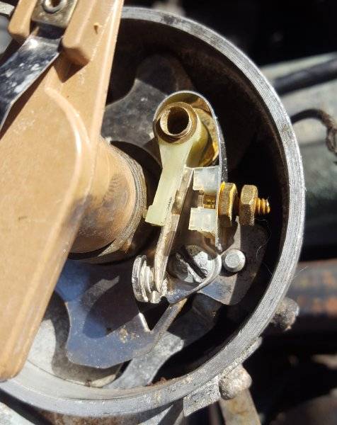

So I looked at a distributor I have off a 383, which has a plastic piece and the points screwed to the opposite side.
I'm going to switch the 325 points to the other side where they can be screwed down.
It appears the purpose of the plastic piece is to isolate the points from the distributor., but I can't swap in the other points.
When I look online for new points, nothing in stock anywhere, there is no plastic isolator, in the pics at least.
I looked for points for my 64 Fury and it shows one with the plastic piece, one without.
Seriously, they don't even give you it, I'd have to reuse the one I don't have?
I did not install the points, but I definitely should have caught this sooner.
