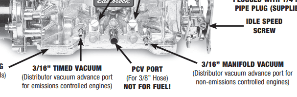

2 - Edelbrock says to hook non-emissions cars (like my 67 R/T) to the manifold vacuum for a 750cfm Performer like on the car currently. It has both outputs.

Clearly here the Edel 1411 install manual says to use MVA for "non-emissions controlled engines", i.e. the 440HP in my 67 R/T. Interesting this is opposite to what was said in the above YouTube video.......but then again the pic has to tell you that the PCV port is "not for fuel".... so consider the source.....as such, my testing that will occur over the next couple of weeks.
I take it you haven't seen the picture of the edelbrock carb with the fuel line hooked up to the pcv port. Owner was complaining it ran rich, if I remember.....
