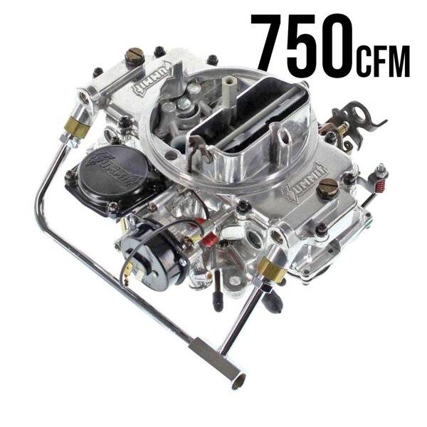

I’ve always liked the smaller Summit carbs on other cars and the fact that you don’t spill fuel due to the bowl design changing jets etc and the annular boosters. Anyone running a Summit 750 with a 440? I’m running a stock cam, intake and a 727.

Sort of looks like a Holley 750 CFM carb.....not sure of the differences.....perhaps someone that owns/uses one can point out the differences between the Holley and the Summit design.....beside price.....China manufacturer??? Just curious....

Zoom in Bob. Not even remotely like a holley.

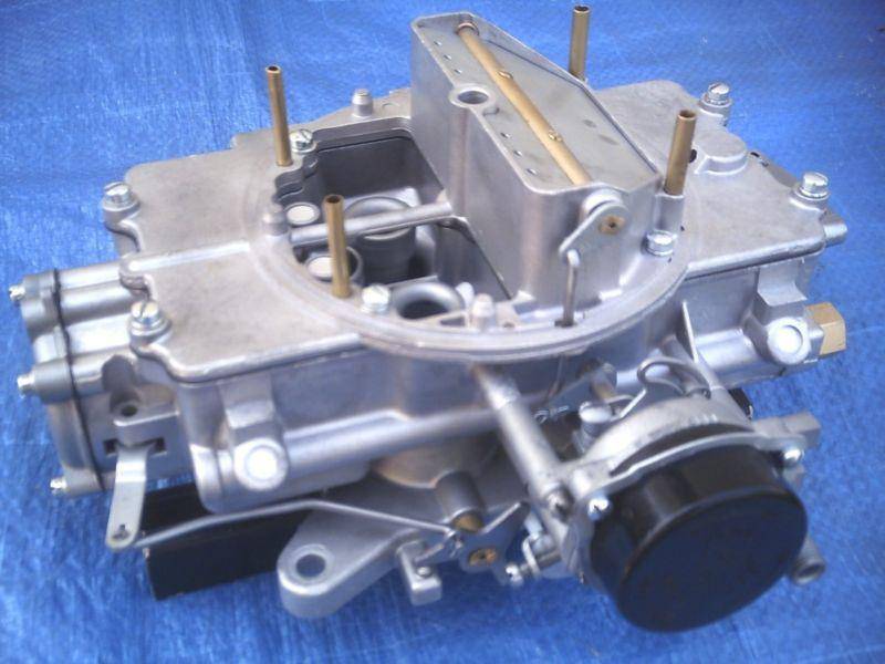

Not even remotely like the Ford-Motorcraft-Autolite carbs of the 60's. The Ford 1100 series 4 bbl carbs, had the secondary opening diaphragm assemnly at the secondary end of the carb and secondary opening vacuum source was an appendage that hung into the tight primary booster venturii measuring pressure drop for the opening signal; plus jets were in the floor of the fuel bowls; the entire air horn is removable without disconnecting the fuel line or removing the floats, without losing any fuel.
The Summit carb shown in the first pix, ZOOMED IN, resembles a Holley with all the external attributes, adjustable floats, metering block, accelerstor pump assembly and lever, secondary opening diaphragm assemnly and choke....with the ONLY visable differences is the cast in Summit name and some scrolls on the body casting..... "copying is the sincerest form of flattery"........

They are quite like the Ford Autolite 4100 series. The ones that Holley copied when they produced their own 4010 series. This is a continuation.
Ford version:

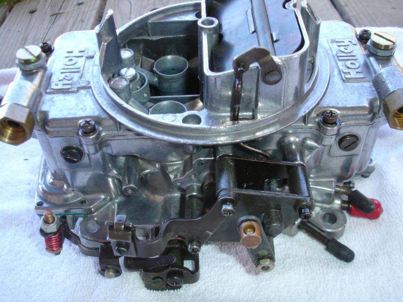

Holley version:
t8LHhcNuhAPw&riu=http%3a%2f%2fwww.2040-parts.com%2f_content%2fitems%2fimages%2f88%2f386688%2f008.jpg
Note the differences between these and regular Holley 4150/60 styles: no removable float bowls, removable top.
You are quite correct.....i misspoke re the Autolite Ford 1100. It is an 4100 series. The OPs first pix was the one I was responding to. My experience....the Ford/Autolite carb was just OK....it used a screw in replaceable main metering jet (like Holley) but larger screw size and overall larger size but had an ## F (F for Ford) designation and absolutely zero speed parts available. Jets were available thru Ford parts only.
The Holley adaption of the Ford 4100 was poor at best but used Holley jets and could be tuned. Not sure if its still made...it used the Ford style of booster venturii. On my Father's 390 Galaxy 500, i replaced the Ford/Autolite 4100 with a Holley Model 4160 R-1850, jetted up a little....everything fit and looked OEM and no one was the wiser.....and ran significantly better.... Apologies for my innitial inaccuracy.

"carb abortion" that's a pretty obnoxious comment. Yes its based on the Autolite 4100 and on my Fords I've run them for years on small blocks without any drama. Its nice to be able to pull the tops off and not have fuel dump everywhere for a jet change. Uses all Holley jets and springs. The 600 comes stock with holley 68's. EDIT: and a 6.5 power valve
Sorry. But this IS a mopar site. :poke::lol:
There is nothing Ford about this carb other than the old architecture heritage. How is this different than any other basic 4150 other than it has Annular boosters and won't mess up your intake? Same tuning options. Same power valves. Same vacuum secondary assemblies and springs, throttle design and choke assemblies. I haven't settled on the carb just looking to have an adult discussion about it.
It is different from the 4150 in that it doesn't have removable fuel bowls or metering blocks. There are no gaskets below the fuel line, nothing to leak. The Holley 4150 is cast zinc, this Summit carb is aluminum. When Holley first made it (4010 design) in the 1980s, they were working off the Ford design - because they had designed the Autolite 4100/2100 carbs that came out in 1957 for Ford in the first place.
