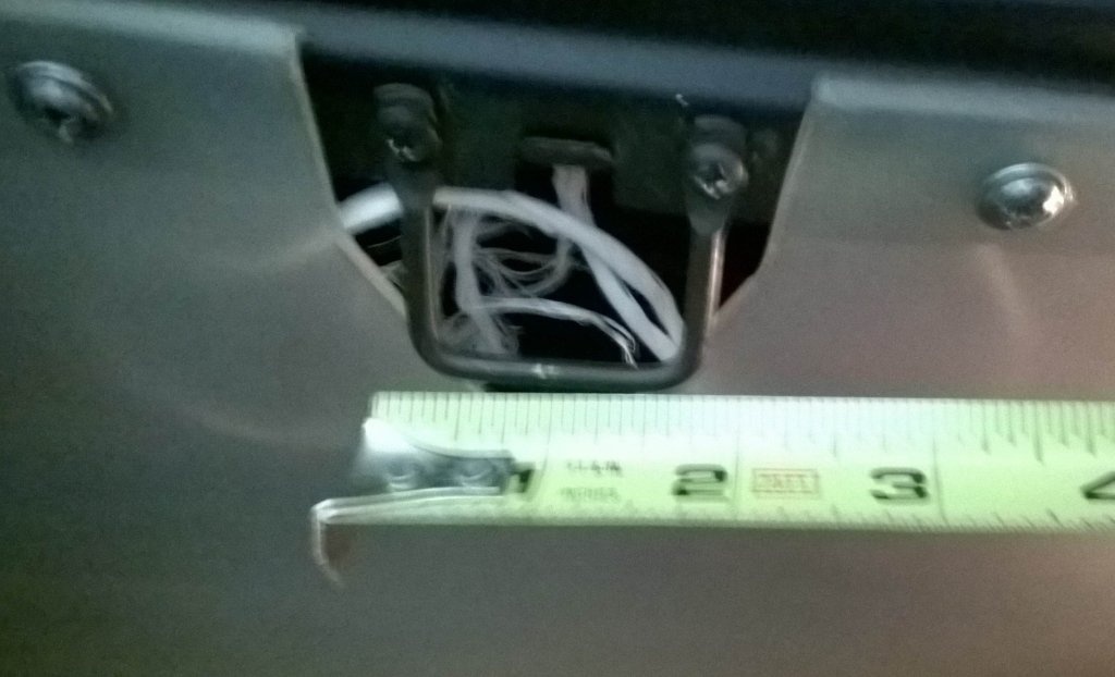

But frankly, it can't be that difficult to make . I have posted a picture of the striker on my 67 glove box lid. It is original but again, how hard can it be to make this with a little time & effort. It is just a piece of stiff metal rod.

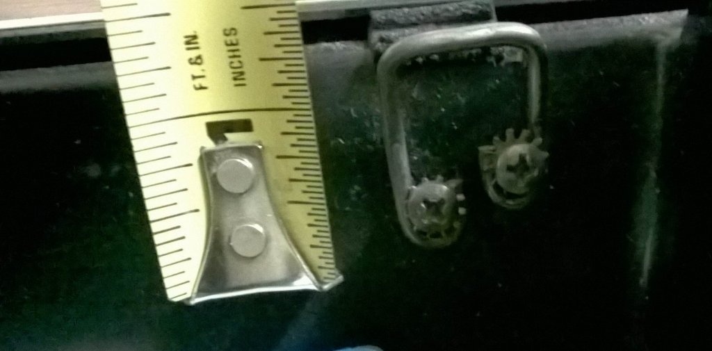

OK, I got out to the garage and he is correct. The one with the holes is for the dash glove box. Console is more like the one on my 67 I pictured.

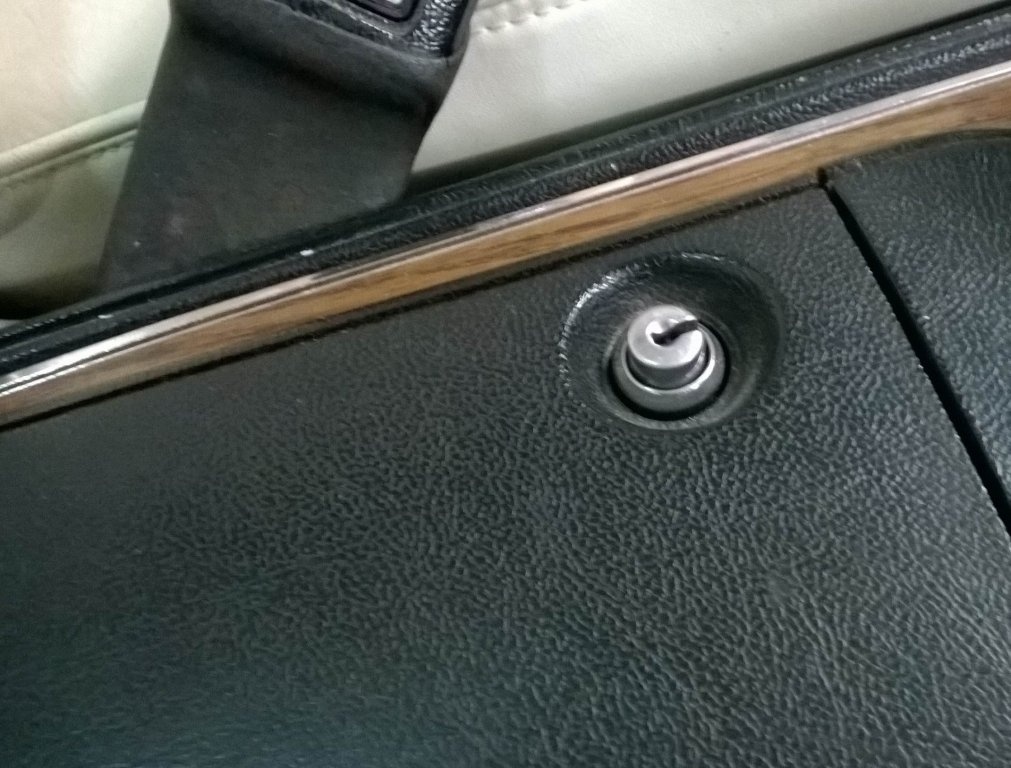

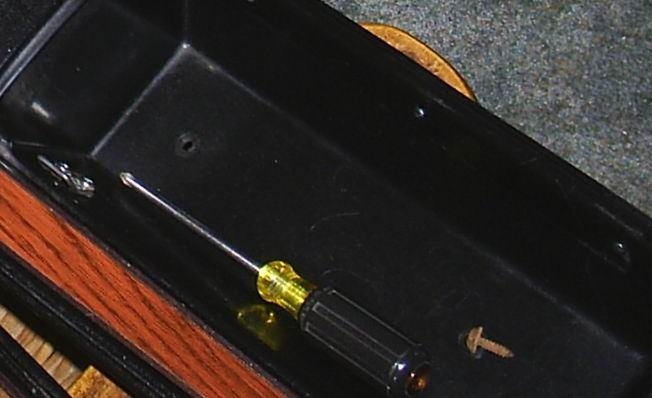

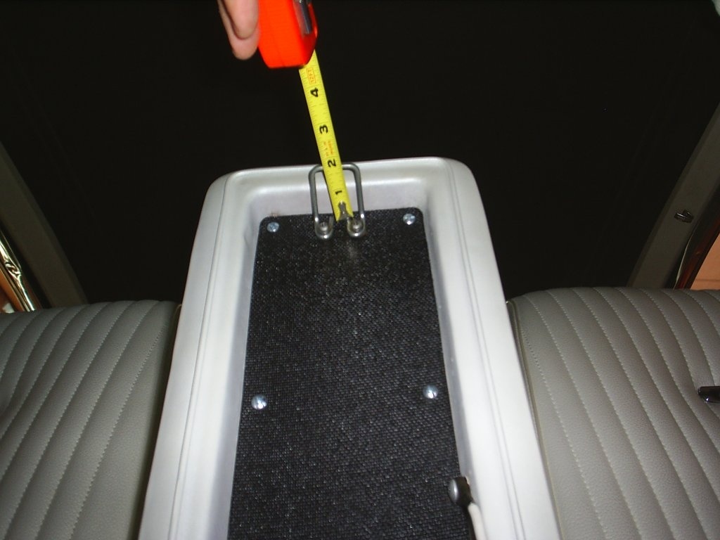

So here are 4 more. I even included the one from the dash, clearly different. Hope this helps. BTW, the part number is 2879805 same as E body 70-74.
Ahhh it does look easy to make. Its just bent rod.
So looks like 1 1/4 inch height
