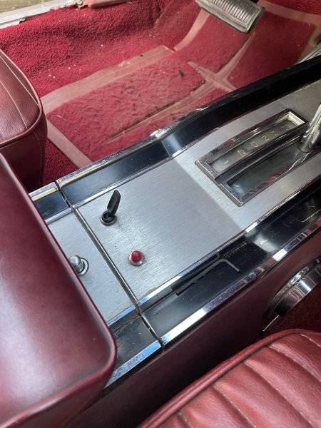

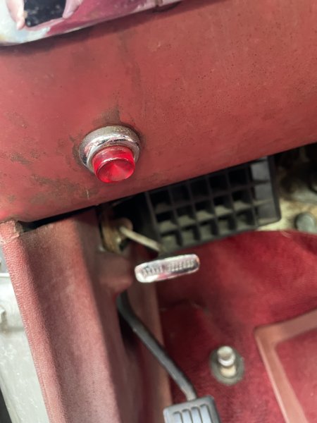

So there’s a red light under the steering wheel. And a switch with a light in the center console. Can’t figure out what either of them do…

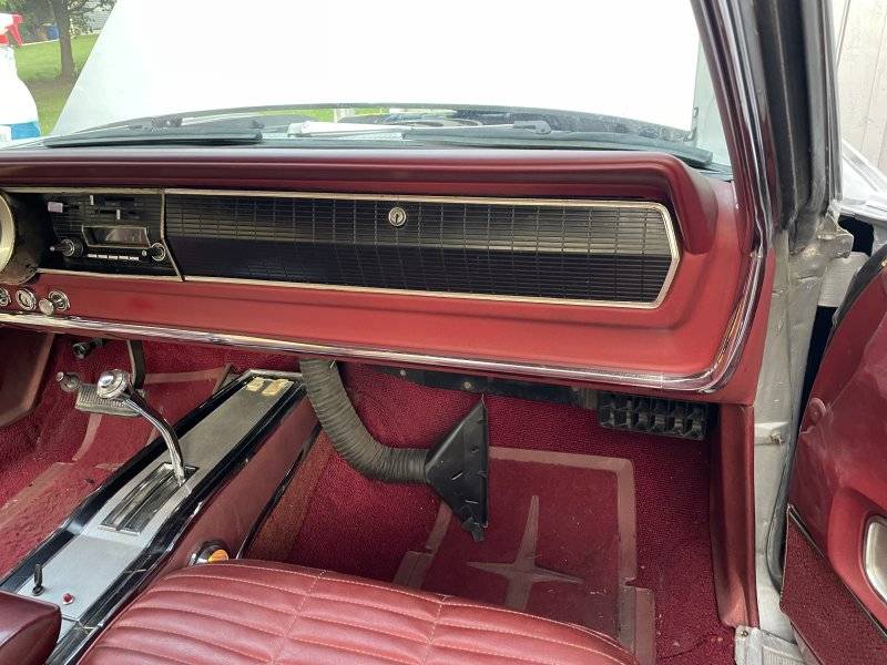

Also any tips on getting the glove box open? The key just spins the lock. I’d imagine that heater you see on the floor can just pop back in but I bet I’m wrong and it’s going to take me all week to fix.
Red lamp on dash is brake warning lamp
Console stuff is added
Defrost vent, the tabs break off the ends. Good ones have a hole on each end, studs and nuts mount them to the dash.
Smoke generator to blind the cops for a quick getaway.

The glove box button is already all the way in. You may have to push the door in a bit to get the latch to release.
Oil slick switch.. Oh wait Mopar valve covers provide that. I guess I will stick with the ejection seat..
