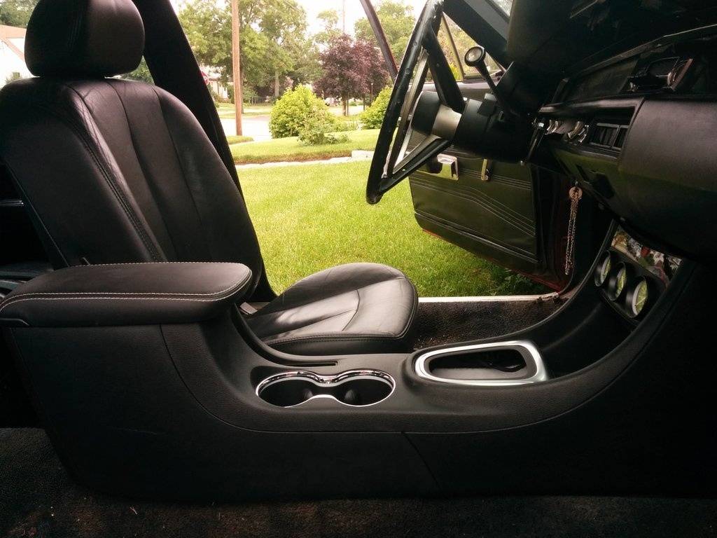

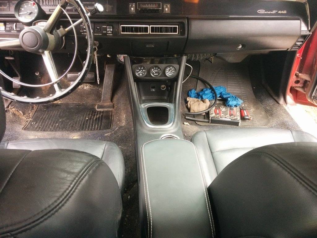

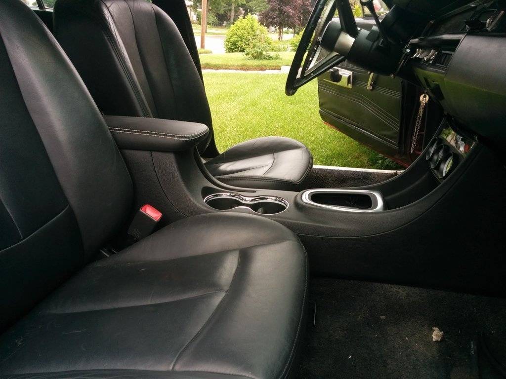

I swapped in a 2014 Chrysler 200 console in my 68 Coronet Wagon

I can't take credit for the idea of Chrysler 200 console. I read on another forum. I couldn't believe how well it fell into place. The front kick up is perfect for my b body dash. I also connected the cup holder soft lighting and the power port.

Nice! Can I ask how you mounted the front portion to the floor/hump? Looks like the radius over the hump is spot on too. I've devised a bracket but not convinced yet this will be adequate using a plate with angled stock to form a seat on the sides of the hump. Might be on the hunt to find a 200 console!
I actually used small 90 degree angle brackets to attach the top of the console where it meets the lower dash area. I am sure there are other and perhaps better ways to mount it though. I paid $75 for the console. I think it was via ebug.
Here is a shot without the passenger seat installed. BTW I didn't install the console until laid the new carpet but I don't have any pics
