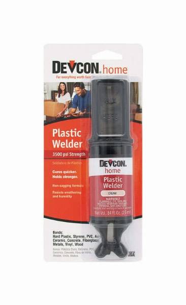

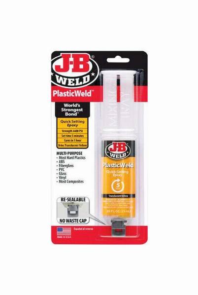

What is the best thing to use to repair cracks on center console on a 68-70 B-Body?
This product worked the best for me. It is plastic weld, a two part epoxy product. I have used a couple different brands and both worked well. Make the bond on back side of the plastic. Clean the plastic very well before applying the plastic weld, I used lacquer thinner to clean it. Spread the weld wide across the crack.

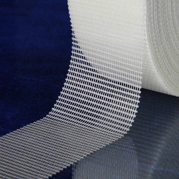

I've been doing some repairs like that with regular jb weld and fiberglass drywall repair tape for reinforcement. Of course from the back where it's out of sight. Rough up and clean the surface, spread a layer of jb weld, lay down a strip of fiberglass tape across the crack and spread more jb weld over the top.

Thank you!

Thank you!
