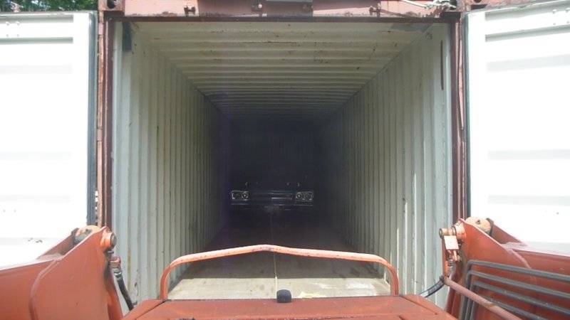

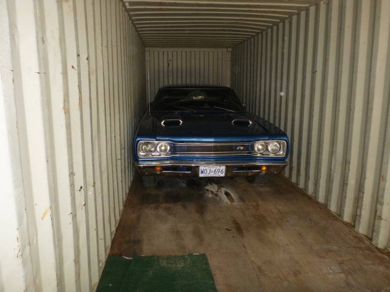

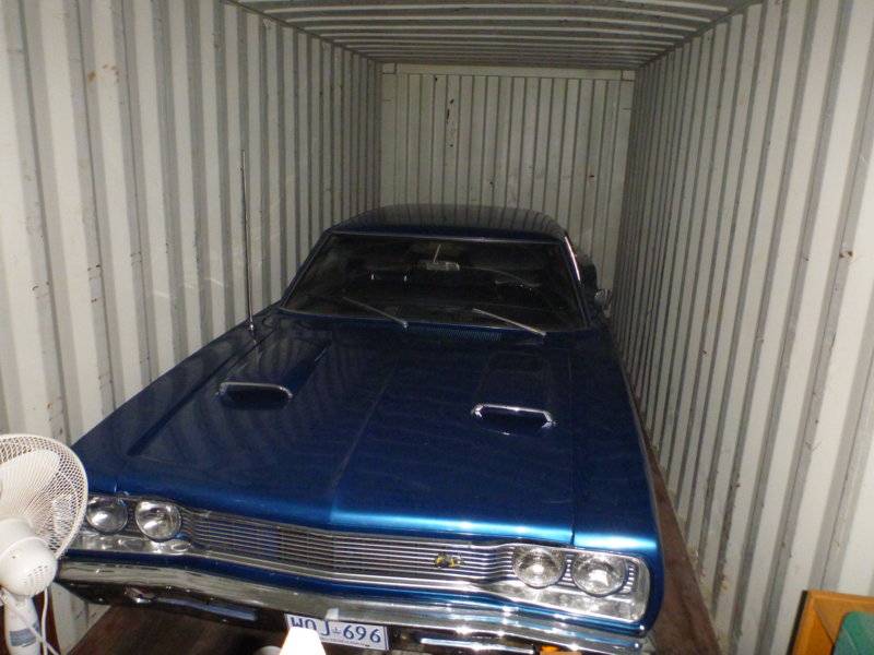

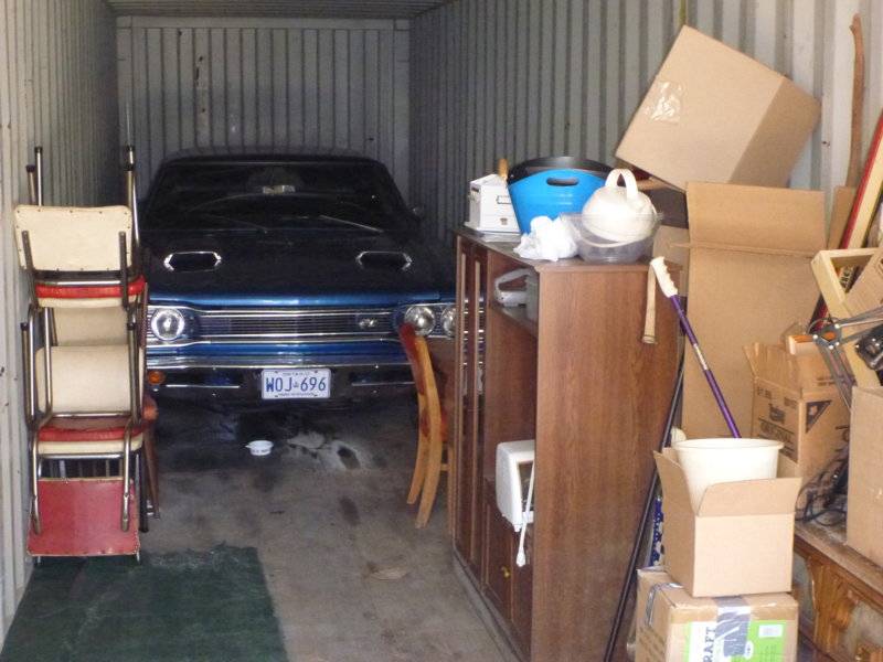

Does anyone have any pictures of cars in these containers?

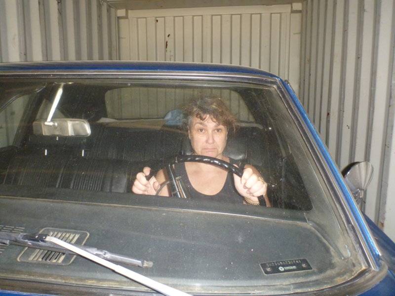

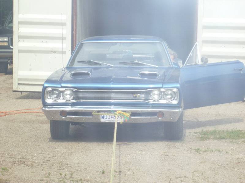

I backed it in there more than once.. running and drove it back out. You can open the door just enough to get in if you park it TIGHT to the can on the passenger side. Only reason I pulled it out was it hadn't run in 14 years and one brake drum was stuck.
Make sure the can you get is DRY and well ventilated. In the summer it will become a "dutch oven" and in spring/ fall may sweat if you don't have it vented well. I have three containers, this one stays nice and dry, one "rains" from the ceiling and the other is somewhere in between.
Heat cracked the steering wheel in multiple places, but it had already started before I put the car in the can. Also caught it once with the interior covered in mold but a thorough soaking in Lysol fixed that.. and I'm still riding on the same seats!

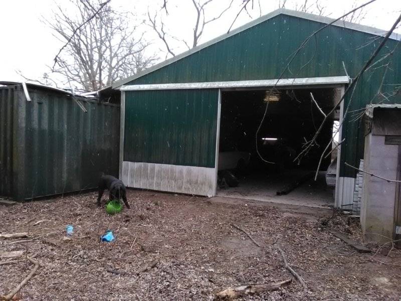

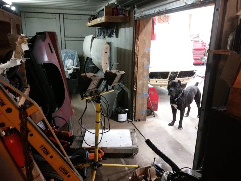

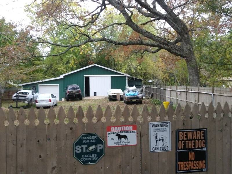

I bought one and installed a roll up door on the side...... squeezed it between my building and the 6 foot fence (I had 9 feet to work with lol) I cut a hole in my wall to line up with the roll up. It's pretty much out of sight. I put a roof over it......it stays nice an dry. an extra 320 sq feet of storage.... been there since 07
excuse any mess, in the middle of major clean up and re-organizing
rear view no one sees, gonna extend the building out another 22 feet soon
...faces north, needs a good power washing lol
tall fences make for good neighbors.....
Nice set-up
What have you done for ventilation?
