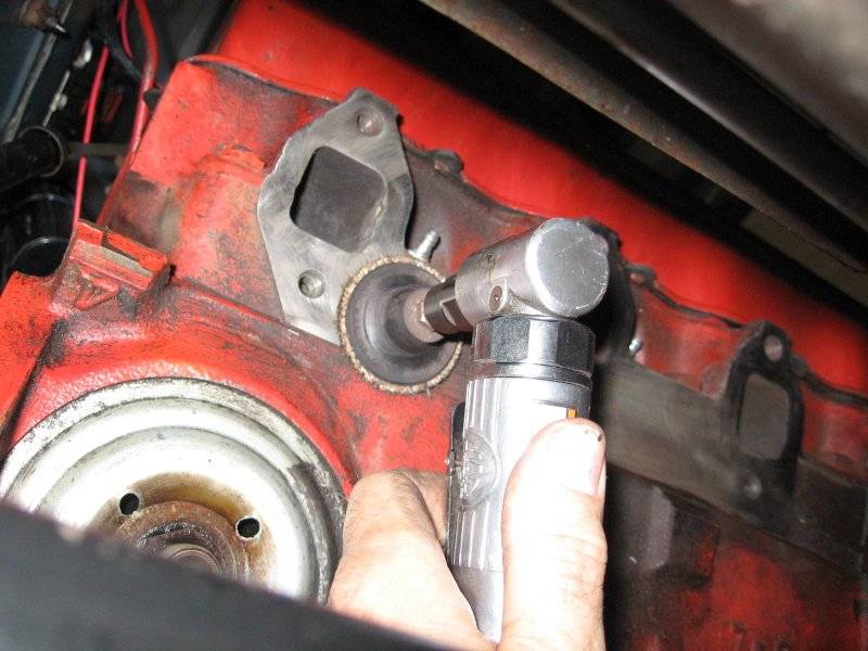

I'm not sure but, I believe all you need is the filter seal plate and the nipple w/hex to install the plate and gasket.
Mike
This is my 64 Poly I thought I had a better photo but it can be seen. The LA small blocks are the same. I think Mancini sells the kit too.
