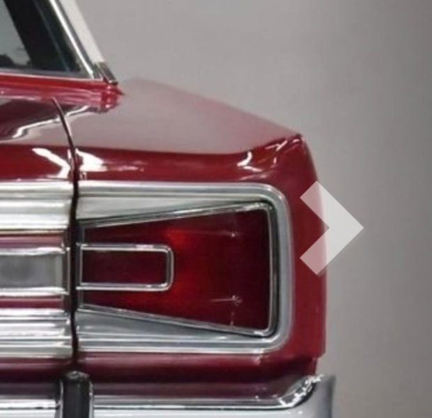

I could possibly buy a 1966 coronet, but I don't like the tail panel (first picture).

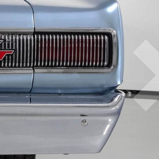

Since I really like the tail panel from a 1967 coronet RT or 500 (second picture), I'm wondering if I can install it in the 66.
Maybe someone tried it already and has made it. Would be nice if someone can tell me.

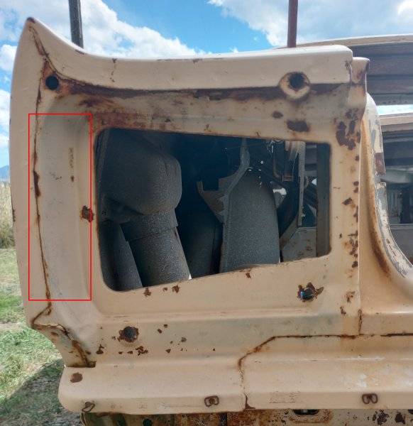

You will need to modify the metal on the 66. There's a difference in sheet metal and the 67 quarter panel extension won't quite fit in the 66. I outlined the problem area in the pic below. This is a 66 and it's wider than a 67 in the outlined area. Just enough that the 67 extension won't slide in there. Should be doable though with a little cutting and welding. I'm actually going to be doing the same thing.

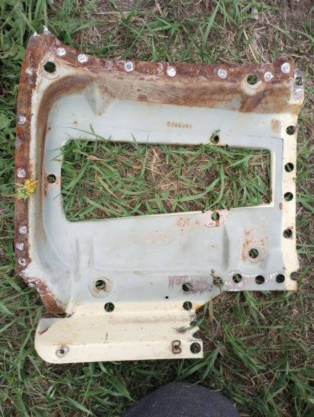

Here's a pic of the 67 sheetmetal for reference. You might be able to find someone selling a 67 parts car that could cut these pieces out. It would be some work but should look stock once they're in. Or might be easier to just modify the 66 metal. Sounds like Germany has some crazy rules on cars.
I am so thankful for the help. The work on it would be the smallest problem. The main problem is, that you can not buy these parts here. There are no car parts in germany. Maybe some VW Golfs or Polos LOL
