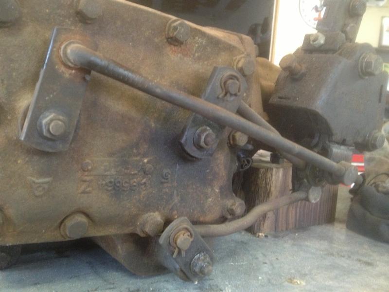

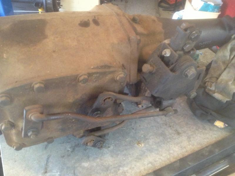

Here are two pictures of my transmission. It has an old, but aftermarket Hurst shifter with the two bolt style lever. Maybe you can look at your linkage and see if it looks the same...

I would like to help with an answer but my 70 RR shift rods are different than the 69 RR shift rods, so not too sure. Found that out the hard way already. So, I do not want to steer you in the wrong direction by thinking I know something that I probably do not. That has gotten me into trouble too many times already.

Thanks Hawk, I'll check mine out tomorrow, I think they are the same.
