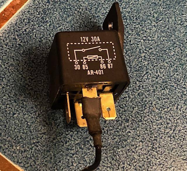

On the advice of FBBO member @1 Wild R/T , I ran the power to the starter relay though a Bosch 20/30 amp 5 pin relay.
I fabricated a metal clip that hooks onto the bottom of the dash where the fuse box normally mounts with a screw.
Now I can unhook it and hold it in my hand…..much better access but only what the slack on the wire allows
