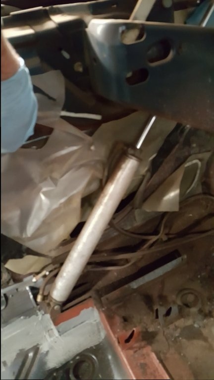

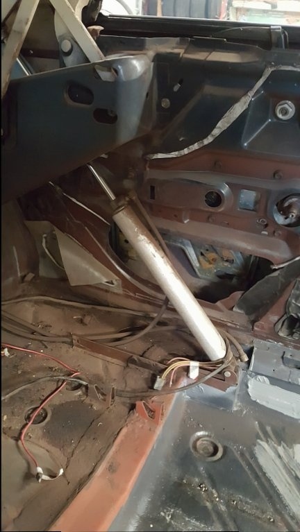

Got it working well and looks like lines are solid full of fluid. It seems it take awhile for fluid to push all air out and need to constantly fill/check. Then i noticed it. One piston is leaking fluid past the seal, not that bad but its leaking and im not about to take any chances. Will replace them both... More money LOL

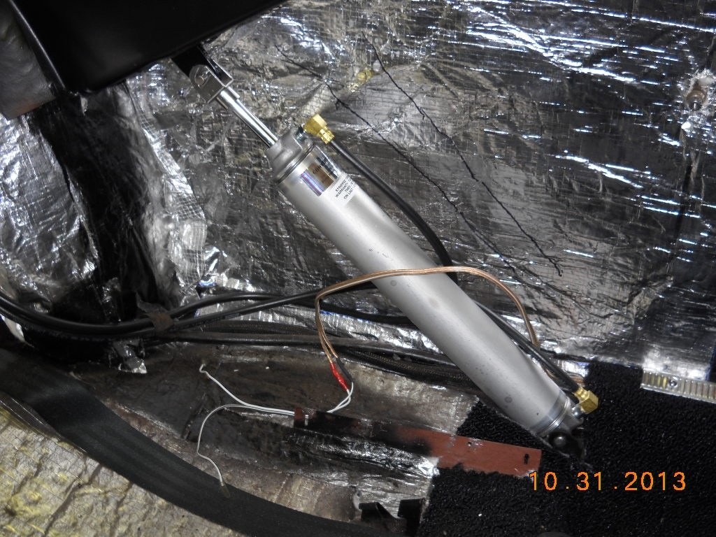

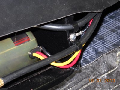

Do have a question. How did you run the hoses to the pistons.in the back were the top would fold or behind the back seat?
Did you have the piston fittings toward the front of the car or facing toward rear of car. Thanks you've been a great help as others were also.

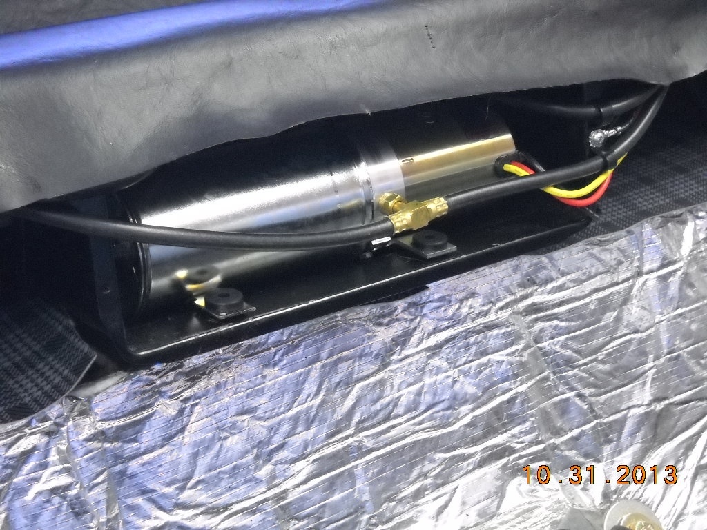

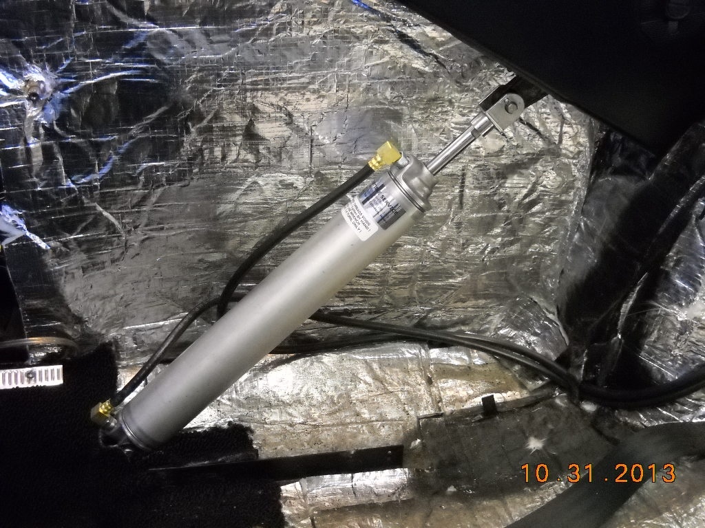

To be honest I haven't seen mine in 20+ years. I dyed my interior panels then, had whole interior out. In one of my posts there's picture, it looks the fittings go to the back. I was also able to find a diagram online by searching 1966 Satellite convertible top hydraulic pump or cylinder diagram. Let know how you make out. If you need a picture maybe I can take one. It's in a tough spot for pictures.
Thanks for the pictures. I need to reroute my hoses for sure. The one piston is leaking for sure. I could probably get away with it for awhile but at this stage of the game replacing them when the interior is out makes more sense for me.
