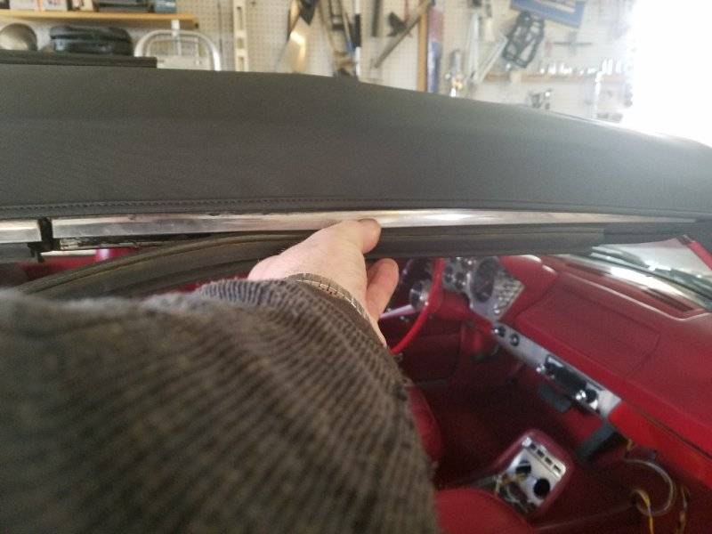

Be oh so PICKY about top sizing. I went to a reputed shop that screwed up the width and length. I measured carefully what looked WRONG giving him the specs. He put on a 2nd one and effed that one up too – just less. Remeasured that one, and nope, he didn’t hear me, though he got the length correct. We had some words, then tells me he has trouble fitting older mopar tops; doesn’t like doing them. I said you didn’t have to take the job pard, I have other places I could have gone to.
Photos show top one and two. Crappier and crappy. Tops look like a shirt too small. Ruins the look quickly. Talked to another place, one I used eons ago on another resto that did good work. He asked who did the work and he wasn’t surprised it wasn’t done right. Grrr
If you’re installing yourself, great, I'm sure you will be careful checking the fit, I'll see what happens with the THIRD top.
