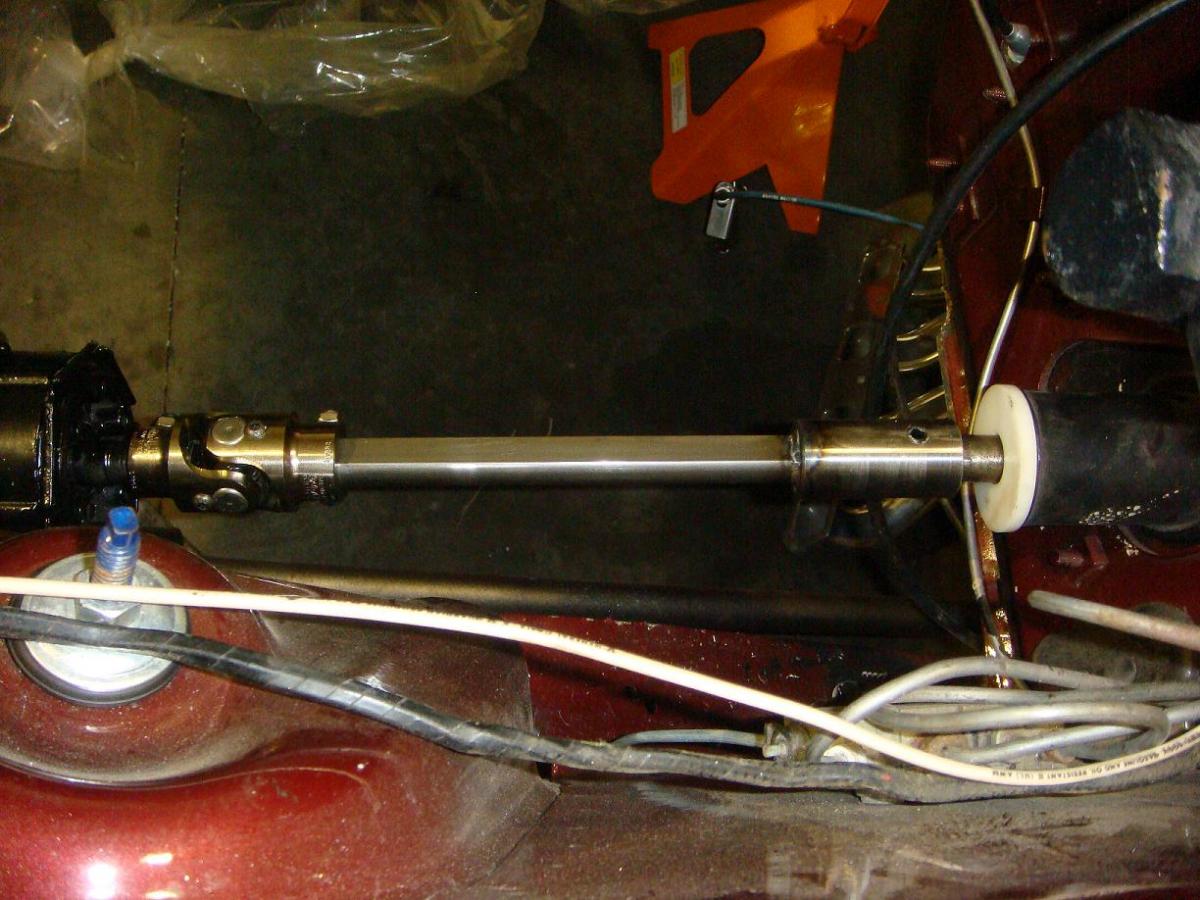

Johnny, I recently did this same swap and it was much simplified once I called Mancini Racing and had them ship me a new coupler complete with a U-joint, and the upper end has the 3/4" DD recess with a set screw.
It took 30 minutes to cut the stock shaft; install the new coupler; and I even tigged a couple spots just for good measure. The unit looks clean and is easy to service.

Here's a pic of the coupler, after installation.
Also note, I make the bushings for the steering column too. I got tired of the cheap Chinese junk bushings and started making them from Delrin.
After I made one for my car, my buddies started requesting them, so, in my spare time, I cut some for other enthusiasts who might want a bushing that will outlast their car.
Here's a link to get you started and remember, this unit can be used to swap either units, and they also sell the short adapters if you need 'em.
http://chucker54.stores.yahoo.net/flristcoad.html
I hope this helps,
Southernman
