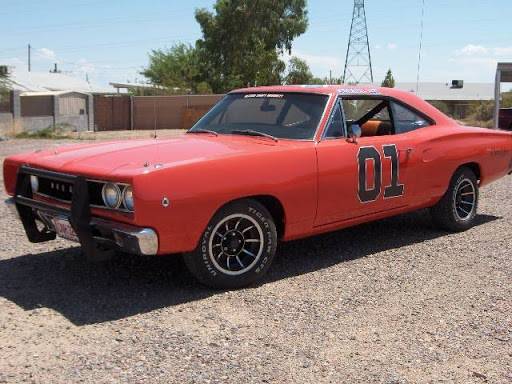

Something like this would be more practical. If your stuck on that idea.
It can be done,the door jambs,outer wheel housings,tail panel,rear valence,corners,rear speaker deck with plenum,trunk floor pan,dutch panel,quarters,roofskin,trunklid,doors,hood,fenders,bumpers,grille,etc. My car was a Satellite.
