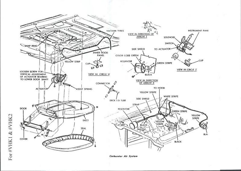

here’s a look of the diagrams...

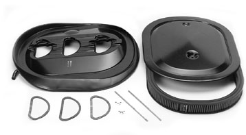

also the n96 air cleaner oval type, easiest to find 70 & latter for 6bbl
{not 4bbl} base
if you have a 2 speed wiper motor
it will hit the base & needs to be notched to fit

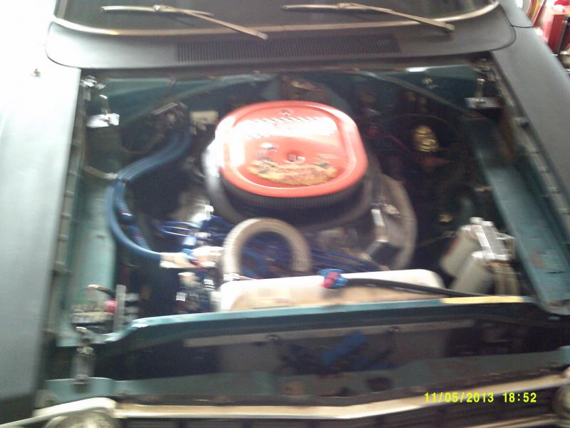

I have a 6bbl on a 383/479ci low deck block, in a 68 RR,
with a 70 & later n96 cold air base & 3" K&N air filter element,
it fit under the OE 68 RR steel hood {I didn't have a n96 Airgrabber either}
the 69.5 6bbls had a flat style base & seal
that mated up-to the A12 lift-off fiberglass hood, completely different
