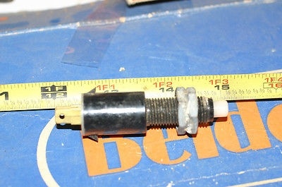

I switched over to manual dual master on my drum to disc switch. I bought a adjustable push rod. Turn into a pain in do-pa. I'd go with the stock push rod first. On the end of the stock push rod there is a bump that comes in contact with the brake light switch. Adjustable rod didn't have it. Had to buy a buy a brake light switch with a lot of thread to adjust it and made a new bracket for it. To stubborn to change to stock push rod after buying the adjustable one. A pic of the switch I put in.
