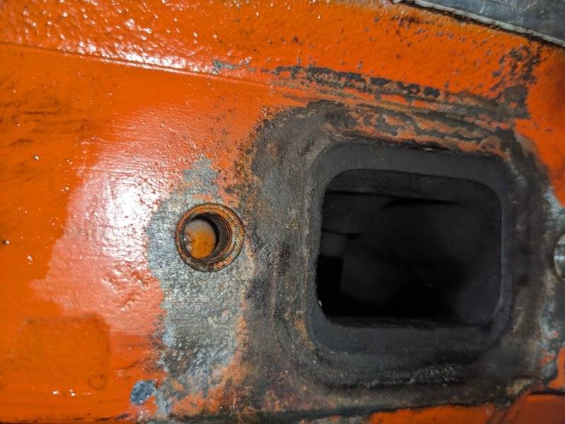

Coolant from exhaust header stud bolt

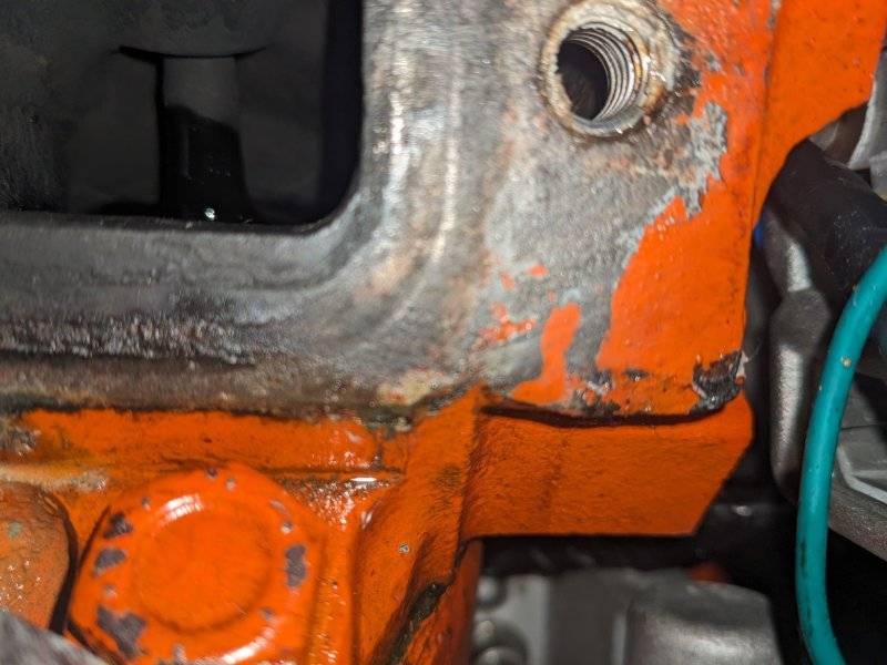

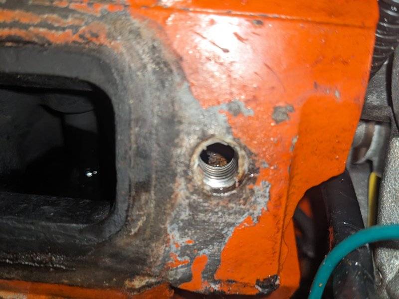

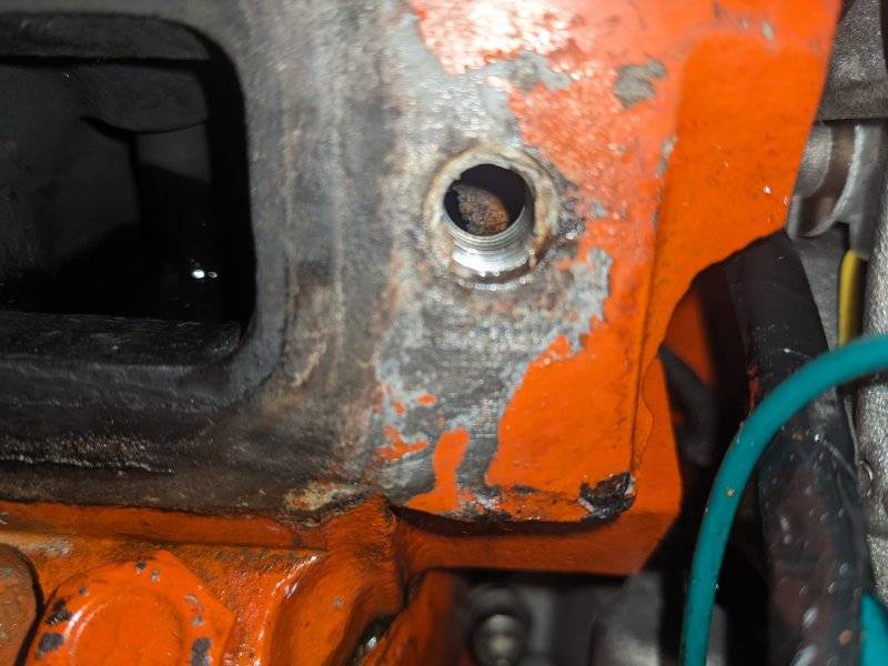

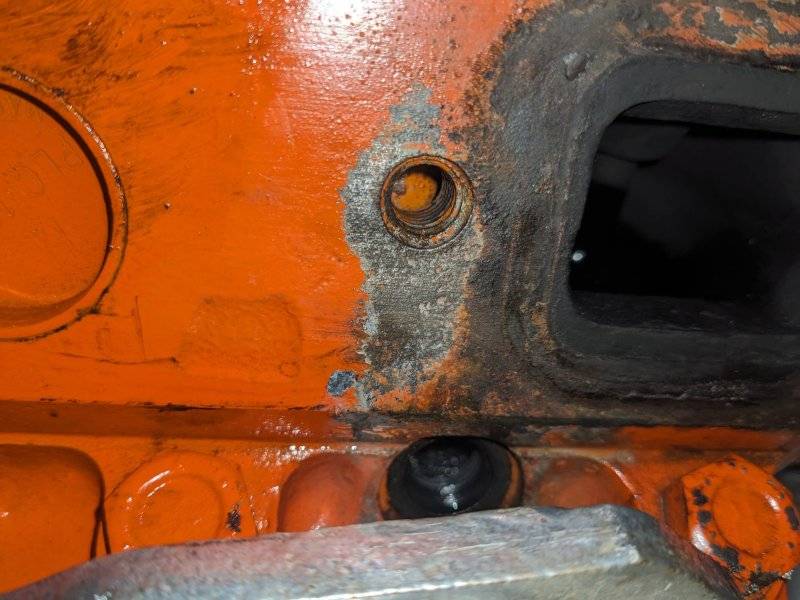

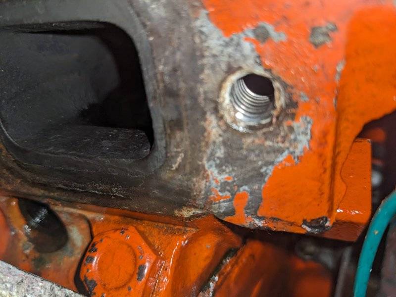

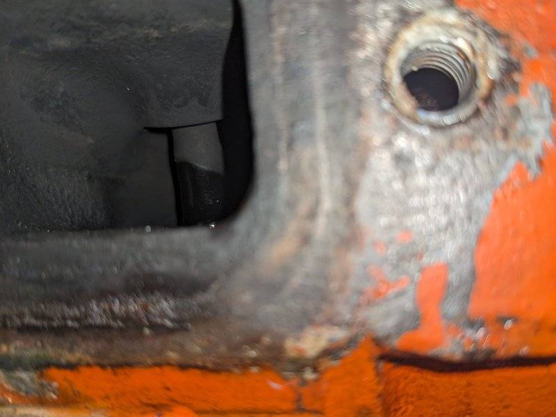

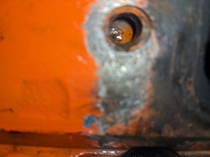

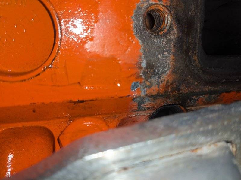

Headers are off. The threads look good to me with no cracks. I added a few pics, maybe someone can spot something I'm missing?
At this stage I suspect the culprit is the second bolt from the front. Longer Bolts on the way.
With either studs or bolts, take a small screwdriver and coat the internal threads with the thread sealant .
Had a leaker on my Bee after a rear stud had to be drilled out. This was the only thing that worked. It’s been in there 15 years now.
