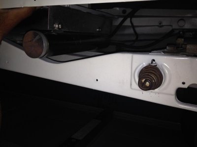

i use an aftermarket plastic container with a wire type basket to hold it on my 65 coronet. i think i got it at advance auto; made by Interdynamics. anyhow, it fits and works perfect. mounted it on the outer left side of the core support. painted it flat black so it wouldn't show thru the grill. be sure to use the correct cap for an overflow.
I put one on the 64 just behind the left headlamp.

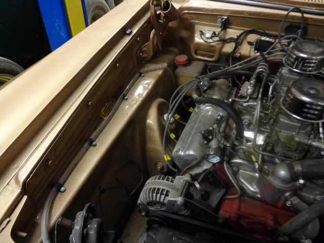

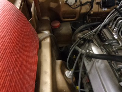

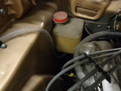

here's my 65 satellite with the original over flow bottle. it's mounted on the rt. side firewall 001.JPG002.JPG003.JPG
wow, never seen one like that!all the on the back firewall! overflow comes in thru the bottom! is that exclusive to the poly motor? finding one like that would be a real needle in a haystack!any body got one?

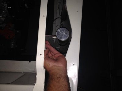

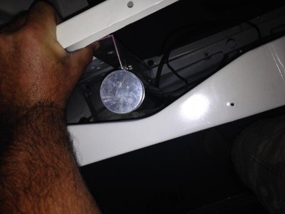

Here's my 65 Satellite...it has a Natural Curve so i thought that would be the perfect spot !! I'm just holding it there for the Pic.
