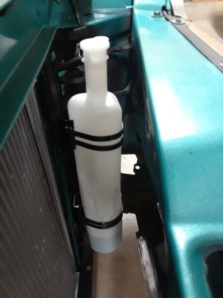

What did you use for mounting? I'm looking into doing the same as either my radiator cap isn't functioning properly or is only rated to about 195-199 degrees, as it will open up and let coolant escape at that temp.
I used c channel brackets from a WiFi antenna kit. The brackets are mounted in the existing holes and zip tie the bottle through the slots in the brackets.
