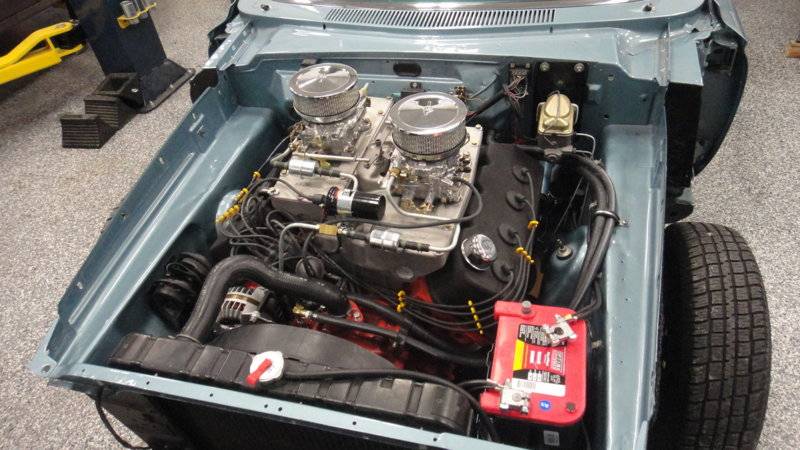

Thank you for the replies. Keep in mind, this is a '64 Fury. There is very little room in front of the fan, and no room for a clutch fan. My 69 RR has the stock clutch fan and radiator with 500+ HP it stays cool all the time. I'm fabricating a shroud now to try to help. I saw this photo on the site as a reference to how much room is available on older B-bodies. This is not mine, but is a good representative of how much room is available with an RB of this vintage.

the space on my 64 Dodge is approx 3". They make a clutch that will squeeze in at 2-3/4"+ (part 2947?) but seems too tight to the rad to me. A dual fan high cfm puller set up might work on the 22" but most I've seen are still 4" deep. It's a tight space on these early B's.

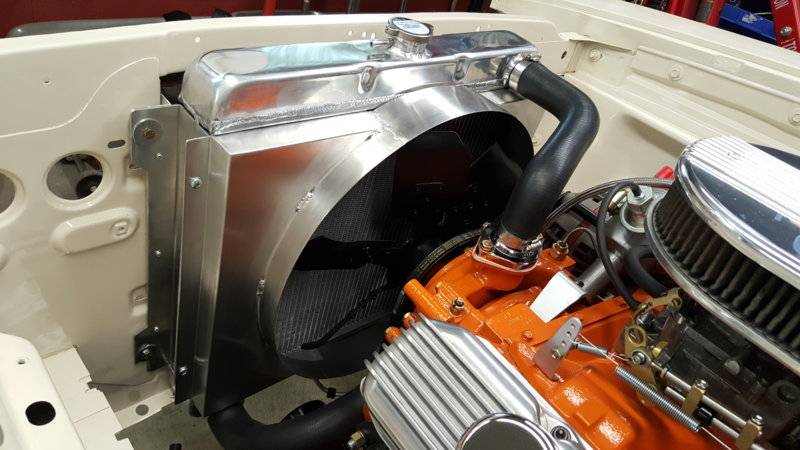

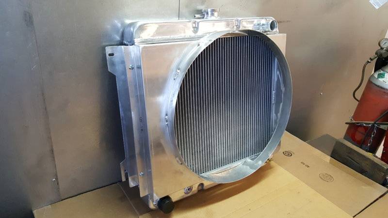

I fabricated a sheet metal and fiberglass shroud to fit my Champion (two 1" core) 22" aluminum radiator with an 18" fixed fan on my 440 powered '64 Polara. Haven't had it out in traffic yet as I just finished the cam break-in. It sat in my garage running at 2000 rpm for 20 minutes with the outside air temp of 105* and got up to 210* during the run.
After cool down I ran it again at idle and set the timing (which was way advanced during the cam run) and then the temp hovered right around 180* which is the thermostat I have installed. Based on this I don't anticipate any problems on the road. Its a mildly warmed up 440 with 9:1 CR and factory Street Wedge exhaust manifolds with 2 2/5" dual exhaust.

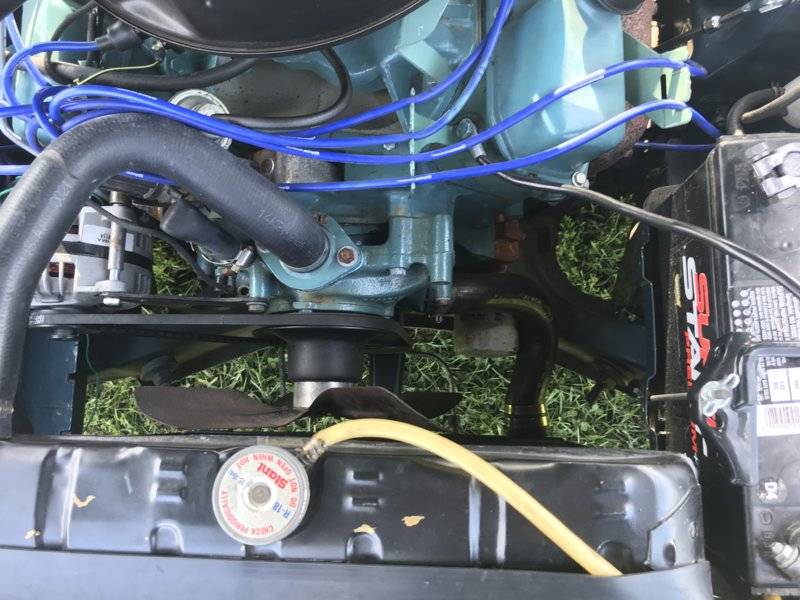

As mentioned in my post, that is not a photo of my car, but rather a representative of the breed. The fan in that photo is a stocker. I have one of them in the attic. The one I'm using is a 14.5" flex fan. It's just as close to the radiator as the one in the photo, and probably moves less air.

I certainly agree with moparedtn. Mine is a race car and way different from the needs of a street driven car which I believe is much more demanding. I had issues also but after reading those numerous posts I've come to the conclusion that it's about your individual combination. What works for some may not be the answer for others. It's still helpful to hear others experiences, cures and ideas. I'm just short of 700HP and after trying two 22 inch radiators (downflow & crossflow), different restrictors, different electric fans and way to much $$$, it ended up being the shroud design itself. Now I can idle forever, car recovers quickly and cools down very fast with the electric fan and water pump running after shut down.

Agree w/shorthorse, the shroud & depth of fan makes a big difference. Myself, never liked/trusted the flex fans, seen too many come up thru the hood. Definitely an ongoing battle with location of the vehicle and driving conditions.
