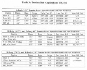

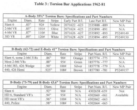

Anyone out there making these? What if any difference in diameter and spring rate are the small block v/s big block tbars?
I just bough a set from the Chrysler dealer I went on summit took the mopar number and ordered them
it cost me 180 cad I used p5249157 on my car
measure length before you order if there longer on your model, my belv are 41 inches long
Hope this clarifies the difference between 72 and prior bars from 73 and up bars including length
