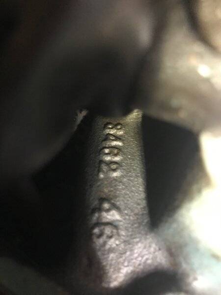

Hello gents - I've got a '67 Coronet R/T project car. Original R/T car, with a 440-4 bbl and 727 trans. I'm trying to determine if the engine is original. I found the following numbers stamped on the heads, which I can't identify. Looks to be 3462 46? Any ideas? Thanks!

Heads won't give you the info your looking for. Need to get under the car and check the casting #'s and look for the shipping order number stamped on the side of the block just above the oil pan. 67 R/T 440's should have 915 heads...which are the last 3 numbers of the casting numbers.
Thanks for the reply - was tracking these should be 915 heads as well. So this is the only numbers I could see with the rockers on - these would be incorrect heads then?

Those heads are 1972 ish heads. You have to do as Nate S described above, to check the block for correctness.

Look more closely, there should be a 7 digit number up there somewhere. Are there freeze plugs in the end of the heads?

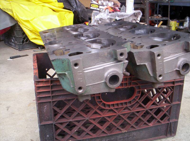

No pan rail numbers in 67. The front pad should have C440 a engine build date and HP. Cast date on the block can be 1 to 3 months before the engine build date. The heads as indicated on a previous post should be 915 and stamped HP on the firewall end.

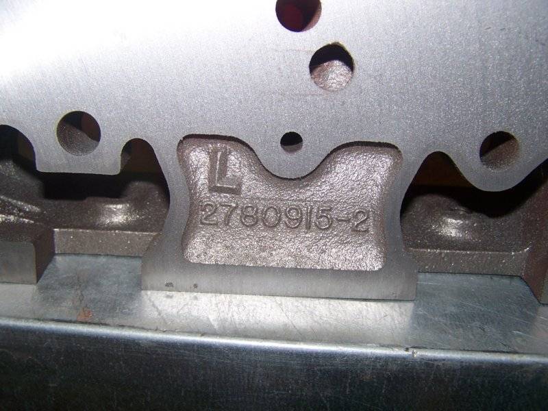

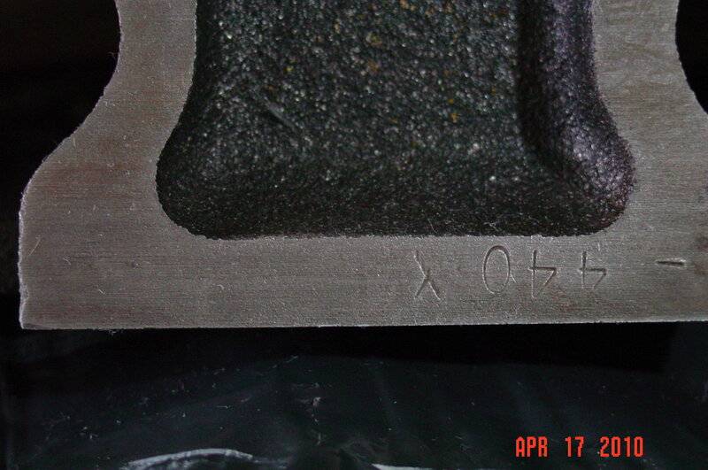

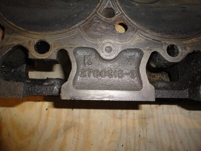

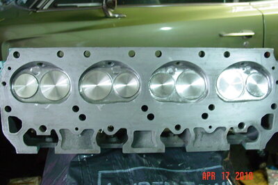

Heres what I know about 67 closed chambered heads. factory HP castings have a large HP stamped into the flat part that accessories bolt to. Small valve 915s do not. Over the counter 915 heads have a 440-X or a 440 HP stamped under the manifold runner. Also large valve 915 heads normally have an "L" cast underneath, small valve 915s have a "K" and over the counter heads have nothing.
67 heads.jpg DSC00152.JPG DSC00155.JPG 100_3135.JPG 7 july 2016 915 Mopar 440 head numbers 005.JPG
