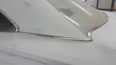

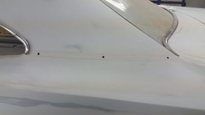

As alot of these mouldings never really fit really nice from the factory, I installed my rear trim and drip rail mouldings and then placed the vinyl top mouldings where they fit nicely. Then I marked them out on top and bottom and proceeded to drill the three holes

Sorry for the late response, I checked today and I drilled 1/4 inch holes, the clips fit nice and snug
