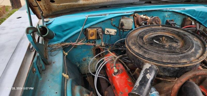

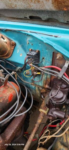

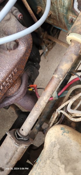

1) This is a twofer: Is that a stock ignition box? Seems like a lot of extra wires just floating there.
2) That ugly rectangular hole, possible aftermarket AC scar?

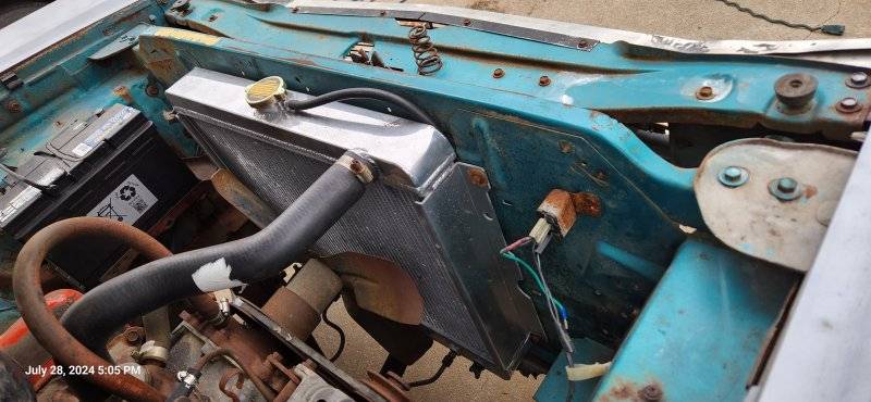

3) Fanciest looking radiator I've ever had in a car, suggestions on what shroud is likely to fit or is best to get and mod to fit?
4) On a 318 where can I screw in the sender for a mech temp gauge? I only found the stock sender in the intake which is too small.
5) I've searched and it seems I have a sorta common prob where I can turn the key to crank, then it takes a few secs for the cranking to actually happen. I have some ideas from other threads to try but here are some pics from the wiring in the starter circuit in case something stands out to someone. Everything seems tight, not sure if its clean but it is tight. Once it cranks the cars starts and idles quickly.
That's it for now, thanks for checking it out.
If that's a 4 pin ECU, each wire has someplace to go (distributor/coil/ballast resistor), shouldn't be any left overs hanging out. I'm not an expert on ignition systems, so someone may correct me on routing, but you shouldn't have any extra wires.
The "black hole" in the firewall looks like the location for the heater core inlet/outlet?
I agree there shouldn't be wires hanging out but it does seem to run fine, maybe some hodgepodge of a later part in an earlier car? Hopefully someone has an idea.
The two pipes for the heater core are above that hole but you can't see them clearly because wires are blocking the view.

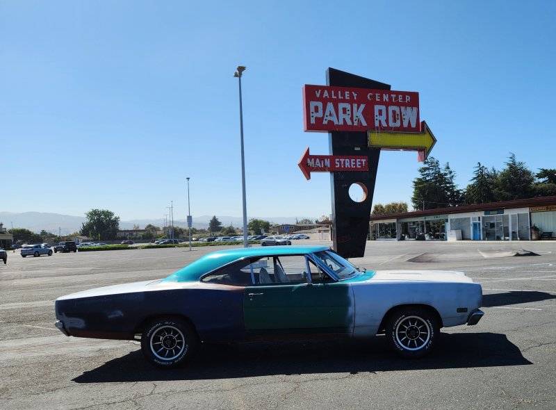

My ONE goal before tearing into this is at least drive it once to the local taqueria, weird I know, but I did that yesterday. First real drive and not bad, maybe I can live with manual steering. I want fatter wheels and tires and not sure if that would be as good with manual steering.

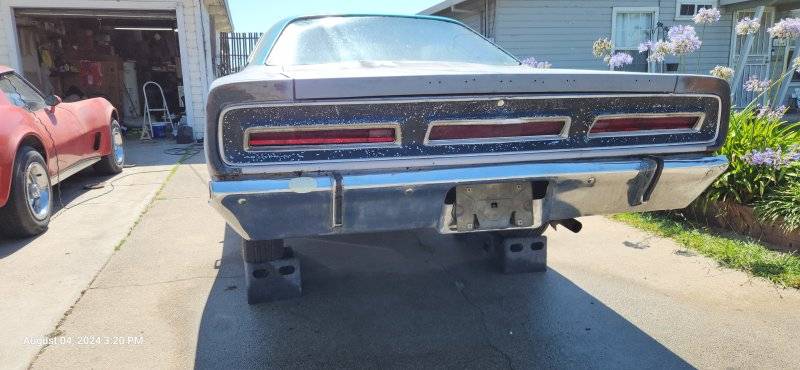

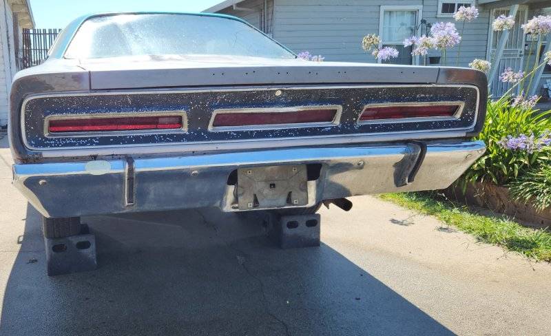

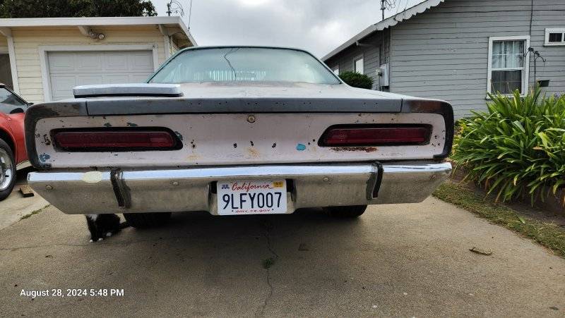

Anyway the only picture worthy thing was seeing how the rear bumper takes a quick SOS pad clean up. It will need another go and a polish but I can live with this old bumper for sure.
Before:
After:
Summit racing sells some generic aluminum radiator shroud kits that you bolt together. Might try that.
Thanks, I have one of those kits in my summit cart that looks like it will fit. I think I’m cooling ok without it if yesterday was a good indicator but I will still get one for peace of mind and to protect my fingers!

Need a fan shroud of some sort. Spray entire can of electrical contact cleaner on Bulkhead Connector for good measure. Good job on rear bumper. Looks good, overriders a bonus.

Yep shroud is on the list and contact cleaner should arrive in a day or 2 from Amazon. Thanks, front bumper is next.

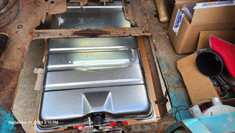

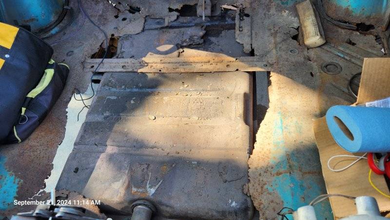

Todays job was swapping the old fuel tank out, had a little mishap and all I'll say is for an out of shape middle aged guy if I spill gas I can sprint into the house super quick, shoo cats away while I rip open a box with cat litter, then sprint back to the driveway carrying the bag in one hand and a knife in the other to empty it!

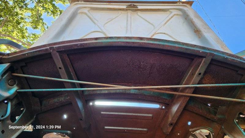

So anyway while the old tank was out and once I was sure the fumes from the spill were gone I also cleaned up some rusty edges where the trunk rotted away. Now here is the random pic dump of today's work for anyone who might actually be watching, because why not, pics are always good.
Except for a couple of small holes the package tray seems to be holding up ok, will hit it with rust treatment

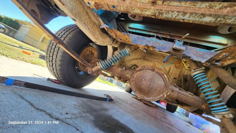

Got the fancy suspension set up here. It came that way, but I think I put those exact springs on a VW Squareback in the 90s to cure a sagging rear.

Looks like someone swapped in an 8.25 diff in the car.
Old fasteners don't like to be forced. It's way better to coerce them into coming out, as you found out. Leave the impact guns out of the equation. Treat old car stuff like a grandparent with arthritis, back issues etc.
Thats exactly what I did. Even beyond bolts I discovered with my last old car, a 77 Vette that some things that don't work will start to if you gently exercise them back and forth, the same is happenning with this car. I'm also slower because I never did much work on a classic Mopar before, its been GM/Ford and Imports, so I go extra slow when learning.
On the rear diff, I actually logged into the site now to look for a recent post with an image to identify the diff since I suspected the same. I want to figure out how robust they are and find a diff cover with fill and drain plugs, partially for function and just for looks.

The 8.25" differential may be stock for that car. I have one in my car that I am pretty sure is original to the car. I did some investigating and it looks like they did use the 8.25" in some Coronets in 1969. If you find the cover for it you are looking for, I would appreciate a heads of what you found, as I couldn't find anything when I had mine apart. Good luck with your build. Cheers!

I dug a little and found some reports that it may be stock as well, for the covers all I've found with a quick search on summit are some covers that are more off road focused and for the price I'm not sure I would want to get one. I'll probably just clean up what I have for now.
One panel can make a big difference.
How it arrived:
How I drove it for a little while (I hit this section with flat black after the pic) :
Now with an eBay find:
Its just cleco'd in for now, I'll screw it and straighten the panel a bit but I think its already a big improvement.
