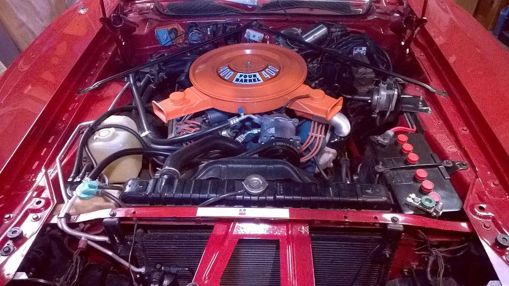

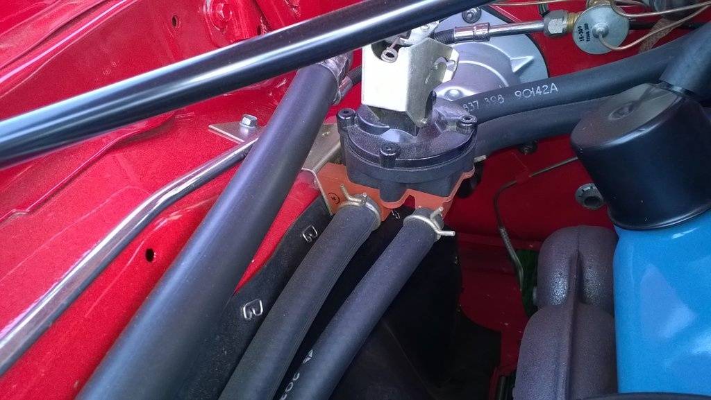

Correct for 73, not sure about other years.

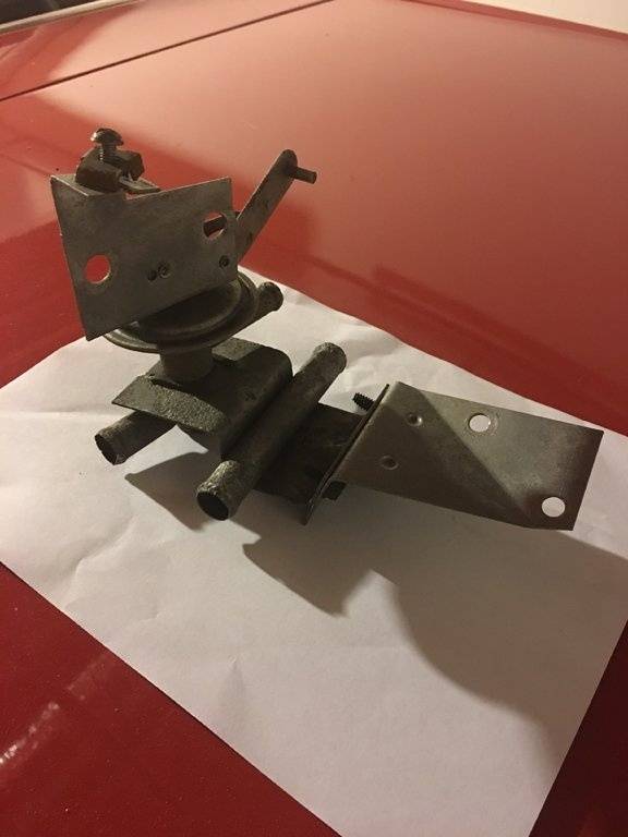

Thank you ODZKing. Gorgeous engine bay! I see you have a phenolic valve that is cable actuated, and you have an a/c car. I have a parts car which has a/c, and it has a cable actuated valve, but the valve is metallic. I read somewhere that the phenolic valves gave some trouble and were later replaced by metal valves. My parts car would seem to prove that out. The metallic valve has a metal bracket that bolts up to the bracket on the fender in your pic. So, it is using a two-piece metal bracket to attach it to the fender. It has the cable that passes through the firewall and goes to the valve, just as your car does.

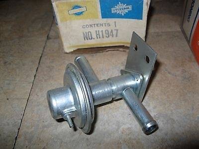

This is what I find when checking auto parts houses as supposedly belonging on a non-a/c car.

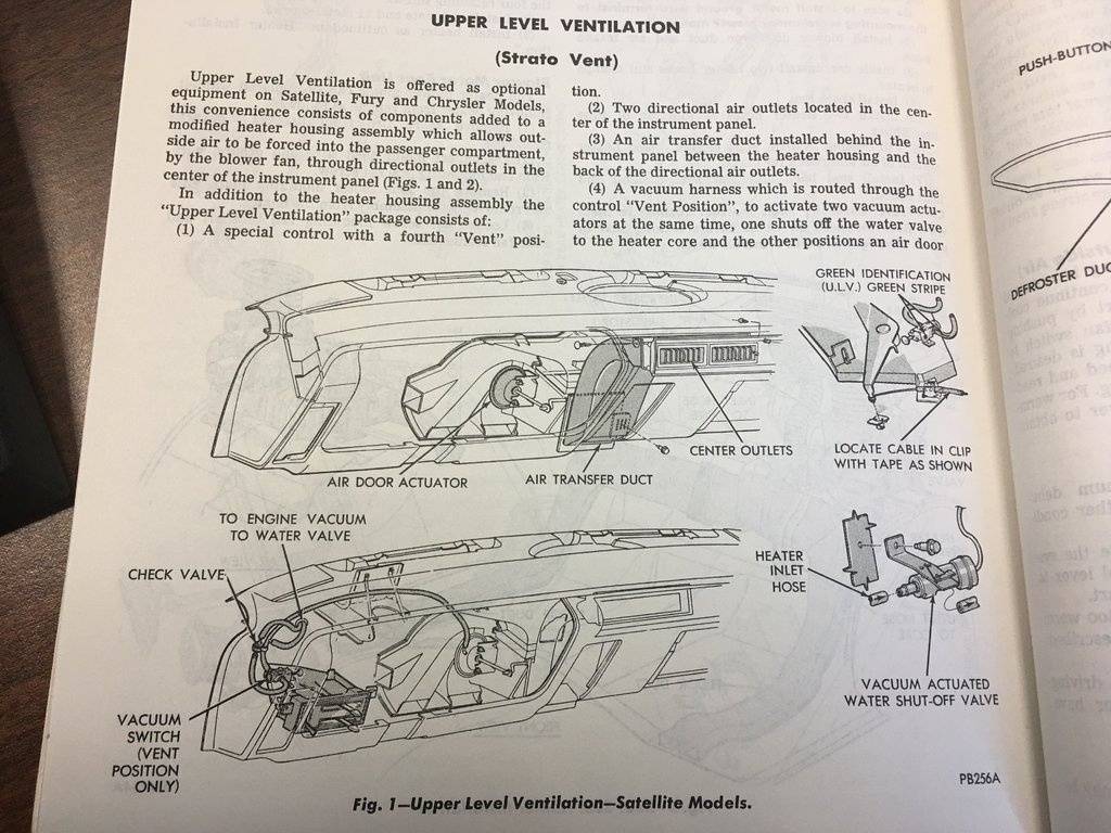

Digging through the Factory Service Manual, I see a reference to some vaccuum controls under the Strato Vent section. My car doesn't have this option. But, perhaps I can use this as a guide to reconstruct what was once there? If anyone has some pics of how this vacuum set-up looks under the dash of a non-a/c car, that would be very helpful!
Thank you but those are not my car, I took those at Carlisle as I need one as well. Actually as you can see from the pic, I have the wrong one on there, but I wasn't going to wait until I found one to get the car up and running. Ha, that was 5 years ago.

I have seen two Factory A/C valves, the earlier type will crack after many years the plastic top part is made from a bake lite type plastic brittle, which always fails over time, I purchased another valve NOS($160.00) with an improved black material that looks stronger and more durable it seems they had improved the material later on in the years when most of the originals would fail. The better material looks more like a mix of polyurethane or something, My thermastat failed, on the hottest of days 96 deg, the engine ran hot but did not over heat, it held up. About 25 years ago my original factory valve failed after an engine rebuild until the motor broke in it ran very hot, cracked the valve but did not leak much. replaced it with a steel valve, and now back to NOS. ( the black plastic you want is a lighter color)
