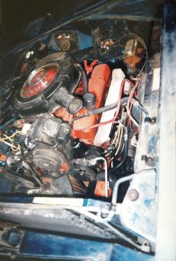

I need your help out there. I have a Dec 1968 build date 69 Road Runner. The air cleaner is a dual snorkle style fully enclosed element black. Based on the history I know about the car It is thought to be original. However the earlier pictures I have (not taken by me) show a 383 Magnum pie plate on the air cleaner. I have always understood the Magnum to be a Dodge term. Any help hear will be appriciated. The engine does match. The car has factory p/s and a/c.

A Magnum pie pan is for a Dodge.

That is the air cleaner on mine. It is a L.A. built car however it would appear the correct style tips came with the car as they too seem to be original. Maybe they were added they are actual correct Road Runner oval tips.???image13.jpg

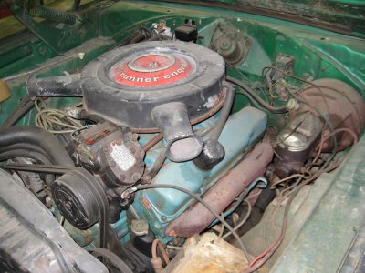

Here is another picture of the engine. I did not know A/C car are rated 330 HP ThanksimageCAY05PG9.jpg
Kinda wierd that it has the Magnum is on it. The car appeared to be fairly correct with the exception of the typical hose replacements alternater etc. Who knows maybe it was added later??

The Magnum tin is definitely wrong. The question is whether or not an A/C equipped RR came with RR pie tin or the Super Commando tin.
It's interesting that the MMC site does not show a '69 RR pie tin.
The Heard restoration book is so full of wrong information that it is virtually worthless as a reference.
Yes. They had the turquoise engine.
Is an AVS 4638 is correct for this CA car?
Yes, that is the correct carb for '69 383 330 horse with A/C regardless of where sold.
Thanks you for all the information. So the engine as it is pictured above in orange is incorrect as it should be turquoise??
I will get the Road Runner pie tin as that would be correct by most standards.
Good news on the carb number as I bought one on ebay thinking it to be correct.
Yes. '69 383 A/C engines were turquoise.
Why would the air conditioned Road Runners get the 330 horse motor?
I've read speculation it was because of over reving the compressor or a cam issue. I've never seen any credible factory info that states why 383-4bbl A/C cars got the 330 horse engine...but they did in 68 and 69. 70 was different.
