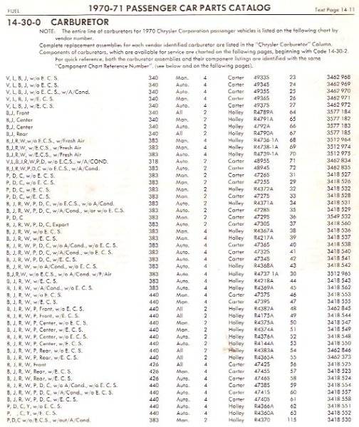

I have a 1970 dodge superbee. 383, Manual Trans, no Air, has PS and PB. I am trying to determine the correct carburetor to install. I do not know how to identify the letters on the left column above. The build sheet says 36.
Thanks
My 70 RR auto, no smog is Holley list #4366
The 36 on the broadcast sheet is the last two digits of the part number.
So, with that being said the correct carb for your application is the Holley R4367A P/N 3418536
Cliff Ramsdell
Also what build date carb are you looking for? Some vendors on here can help if you reach out to them, Harms and woodruff.

A LITTLE HELP HERE TO BE SURE I GET THE CORRECT INFO. IS THERE SOMETING ON THE BUILD SHEET THAT WILL TELL ME?
