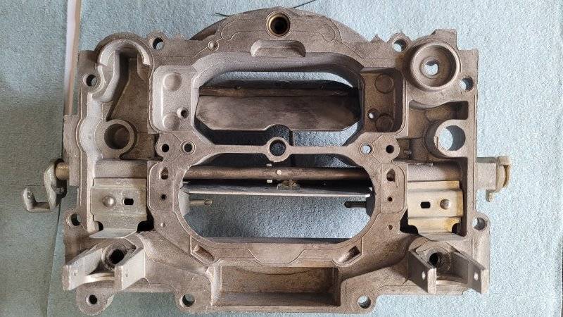

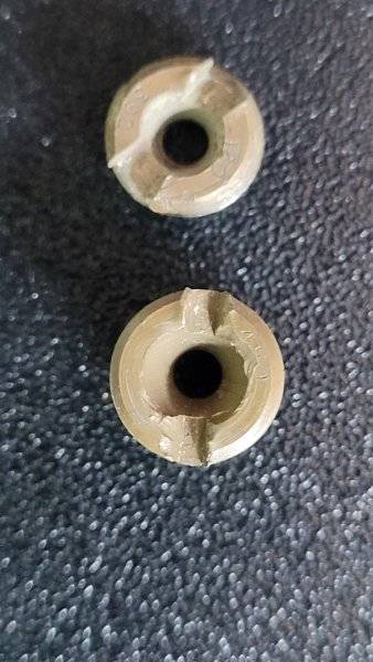

I am rebuilding a Carter AVS 4638 carburetor on a stock 383 (Vin H) Automatic with A/C. Build sheet confirms 4638 as correct Carburetor. This carburetor is NOT original but was replaced around 1979 as new (replaced a Holly which obviously was also not original carburetor per build codes).

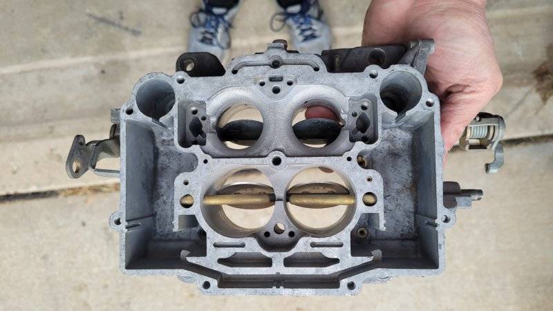

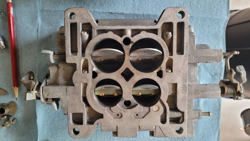

After disassembly I noted the follow with questions:
1. I found two of the jets stuck (on Choke linkage side) and the soft brass already rounded over. I expect the only sure fire removal is a drill and extraction tool (left hand thread) to force them out as there is not much to grip onto at this point. Before, I do that, I want to know how to identify the replacements and availability. I snapped a closeup of the two from the accelerator pump side. At this point I may simply clean the carburetor with these still in place. See picture.

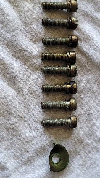

2. The 8 screws holding the air horn to the main body have several with "failed" lock washers. 1 is missing completely and 2 are broken so that the washer no longer has the overlap (to lock). Are these stainless steel washers of standard size for the screw? See pic

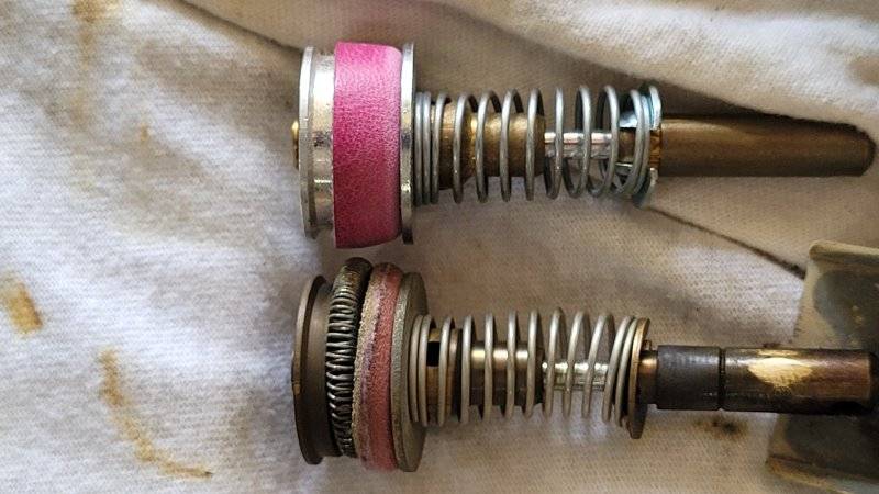

3. The prime failure reason for the rebuild is the Accelerator pump. Any acceleration at any point failed. When I opened up the carburetor the piston leather had shrunk down so far the spring behind it was in full view. So that part is an easy fix. No questions here but you can enjoy a pic of a completely failed/shrunk piston.
4. There are two gaskets for Carb to Intake manifold. one thin and one very thick. I have heard mention to use the thick one to "lesson" the effect of the "hot fuel" problem. Which should I install.
Knowing the Accelerator pump was my original problem I might simple proceed with clean everything with a normal rebuild kit (new accelerator pump), while leaving two stuck jets in place.
or
do I persevere, I tear out the two stuck jets and find replacements.
Thanks for any suggestions.
Martin
Leave the jets, there are no replacements for the tall primary jets that I know of.
I would probably agree on leaving them, but I would try to lightly de-burr the tapered entrances so they are smooth and uniform.
You do want to go back with a leather pump. They are more durable than the others.

You might try Mike’s Carburetors for the screws although most I see do not have the captured washer and you have to use a standard lock washer. If you only need 3 or 4 replacements I would place a WTB as in the parts forum. I’m sure some folks have some spares from old cores.

The acc pump plunger probably got that way because carb was not used for a long time, leather dried out & rolled up. With the new pump, lube the leather with auto trans fluid.
Screws & washers were not s/s. If you want new washers, just get some from a hardware store.

I have extra screws, but really no need for seperate lockwashers though. They are yours for the asking.

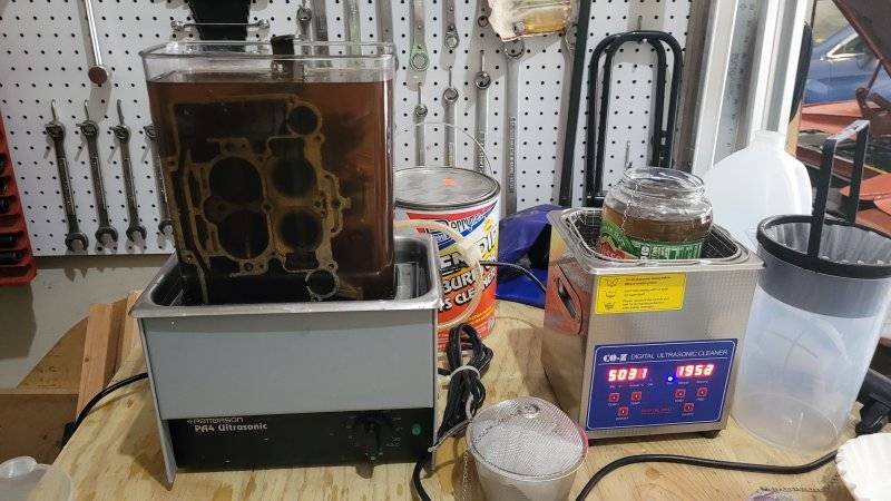

All my parts are rotating through a sonicator with Berryman's ChemDip. Will then wash, dry with compressed air and inspect for any further attention before starting the reassembly. No Jelly or strange particulate was found in the fuel bowls. Just a more dusty residue. Exterior was pretty sticky around all the linkages so cleaning that should help as well as I'm not confident nothing was sticking (position wise).

I have bought carb screws from this company The Shop - Allstate Carburetor
On the Eldebrock they have a replacement accelerator pump, neoprene not leather or rubber. Changed to one of the neoprene ones and haven't had any trouble for years. It's compatible with all fuels. This one is listed for the Carter and might be what you're looking for. Check the size and listing for your carb. Good luck.
Carter AFB, AVS Accelerator Pump High Performance | eBay

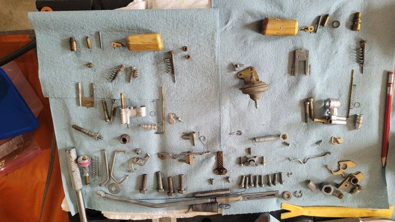

1st pass cleaning done. Looking ok so far. Nothing turning up wrong and passages seem to be clean. Couple touch up items to finish tomorrow.
Used Berrymans ChemDip and rigged up vertical tub (think plastic cereal container) to sit in ultrasonic tub. Cycled 30min agitation and 30min soak for 4hrs. Then wash in warm water and compressed air to dry. Long day but good progress.

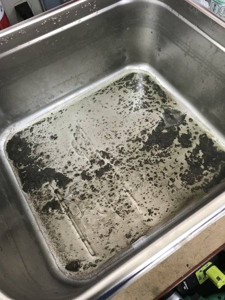

Did you get quite a bit of sediment in the container after the agitation and soak? I was amazed how much silt was in the bottom of mine after doing what I thought was a fairly clean AVS. A lot of it was suspended and drained out with the fluid but it still left this.
I did do a hot water wash first so may have flushed off some of the loose stuff (mostly in the fuel bowl area) but I did not get a huge amount of residue as sediment. I will say the ChemDip solution is much darker now so very fine particulate definitely clouded the cleaning solution but I did not get a lot of particulate. So I was a bit relieved. My carb was not completely out of service but was just not run very regular. I also have always put the Stabil in the gas religiously. Probably not a complete solution but I'm sure helped.
You definitely win on the sediment cleaning.
I was really shocked as I blew the carb out with cleaner first.
