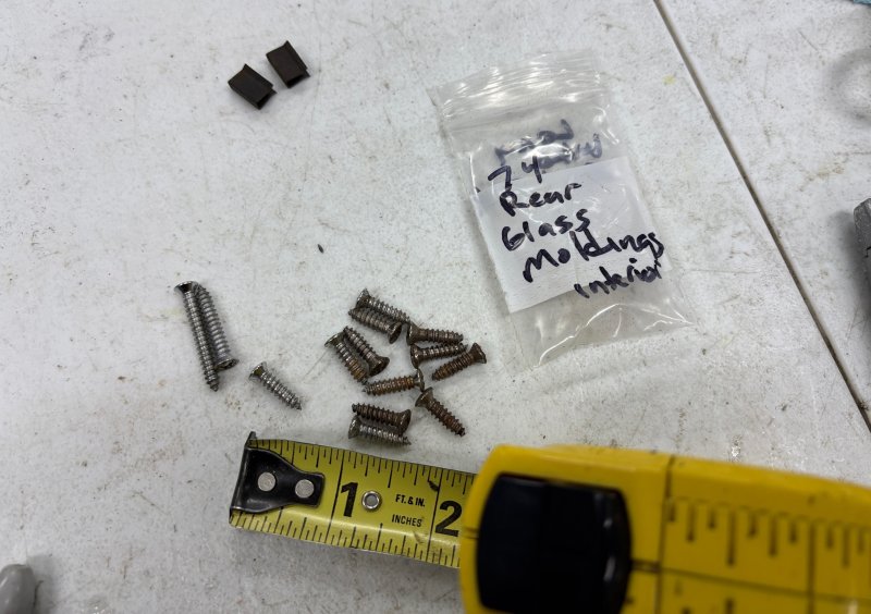

Anyone have a picture of the screws needed for the interior molding for the rear window? Thank you.

Here you go. These have the smaller heads. Long ones go into the sail panel. No idea why my car had two different long ones.
#8 oval head screws, typically 1" to 3/4", I use SS versions. The originals had a slightly smaller head but unless you are doing a concourse car I'd use the more common and cheaper version you can get at any well stocked hardware store or buy from Amazon.
