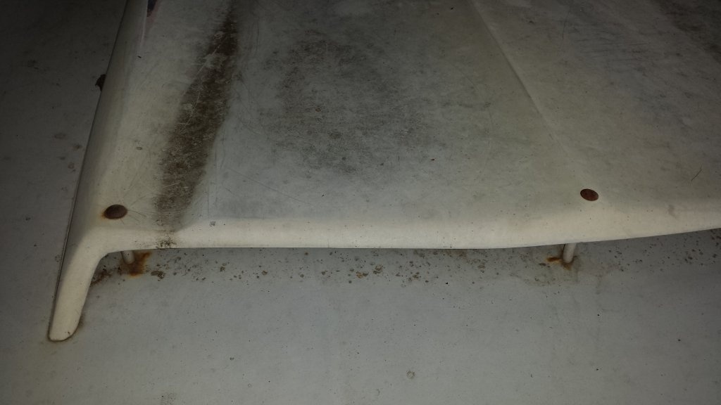

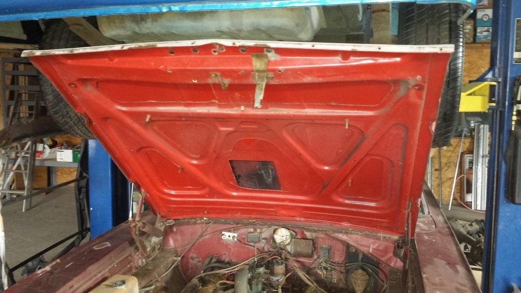

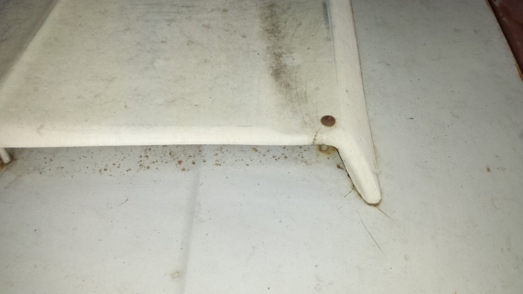

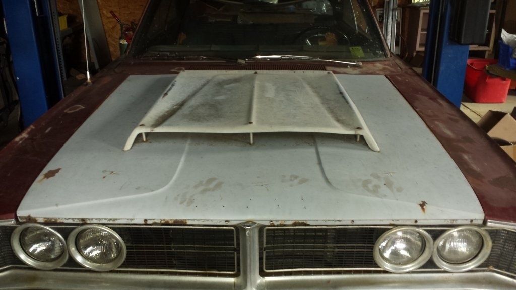

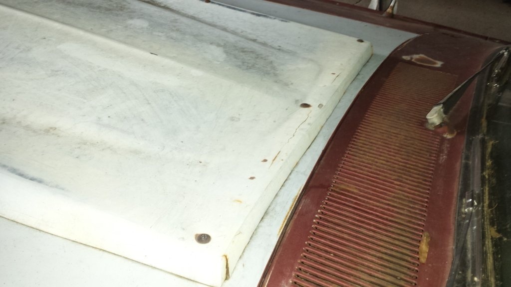

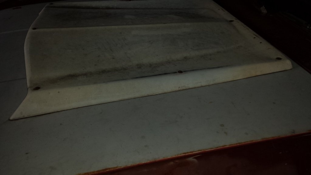

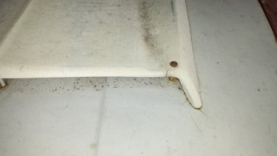

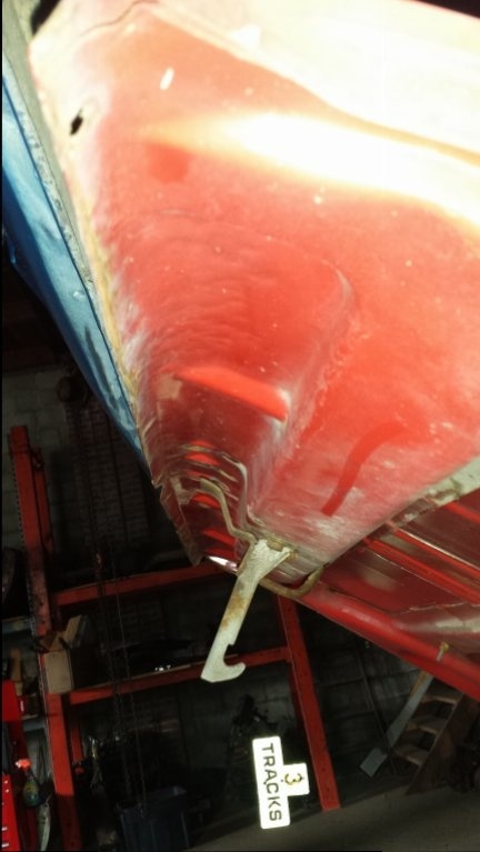

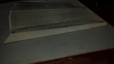

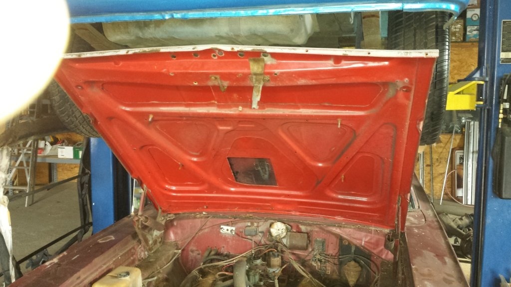

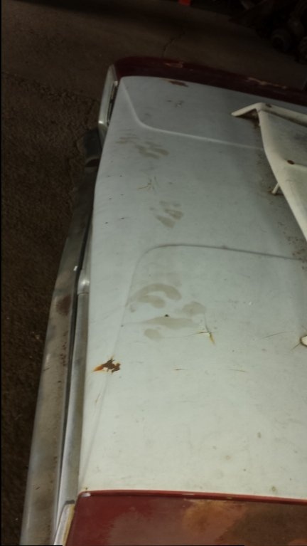

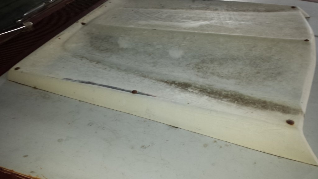

here is the hood i have..the hood is incredibly clean..the scoop is a little crude in my opinion.. 250 plus 125 shipping to a major airport nearest you serviced by forward air...this is for the hood only..the secondary hook and the latch bar are not included, this is for the hood only

Thanks. I was hoping to have a spare for my 66 Belvedere to acid-dip. That's fair for someone looking for a Dodge hood.
