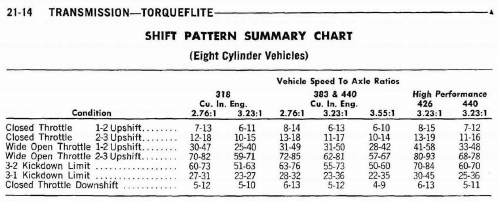

There are two basic adjustment goals listed in the FSM for the OEM throttle pressure linkage setup.
1. At idle, the throttle pressure lever is all the forward, and at it's minimum setting.
2. At WOT, the throttle pressure lever is all the way back, as it's maximum setting.
If you've confirmed things are set this way, and at light (closed) throttle it still doesn't do its 2-3 upshift until 40, this may indicate something is amiss in your transmission.
In my experience with the B&M trans kit rebuilds (for example) we can make it shift fast and hard, but the shift points don't really change. Those are mostly governed by the throttle pressure.
Oh thank you don't remember seeing that my FSM but I'll take a look as well. Probably just blew by it. Yeah I'll definitely make an adjustment soon. I remember on my 318 engine and just normal street driving it would bring third gear in at about 32 miles an hour. thanks for the advice. Will report back to all progress
