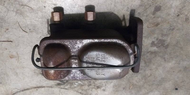

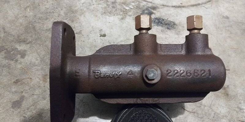

This is the one.
Pm me if you want to buy the core.
fyi, Hemi's outlet is on fender side
