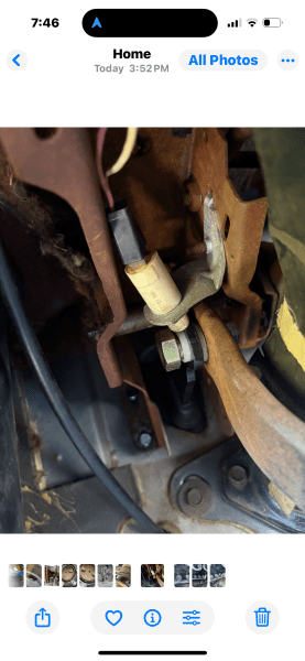

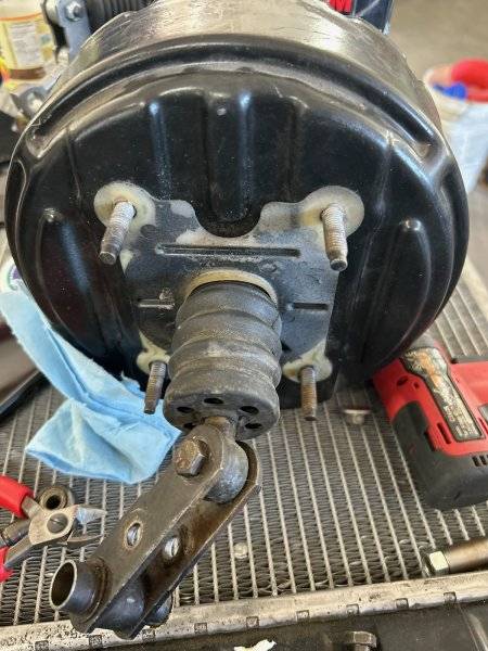

This may help with your questionWhat’s that linkage on the back of the booster? The reason I’m asking is that the prior owner put in a power disc brake conversion and the brake pedal is way too high. The brake light switch also is hanging up on the pedal sometimes. View attachment 1906300

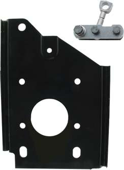

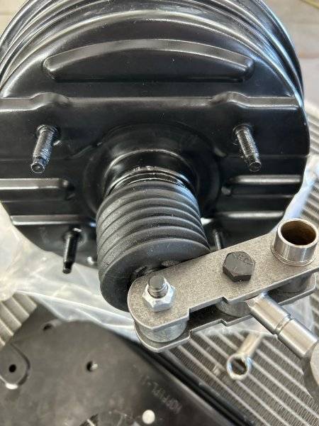

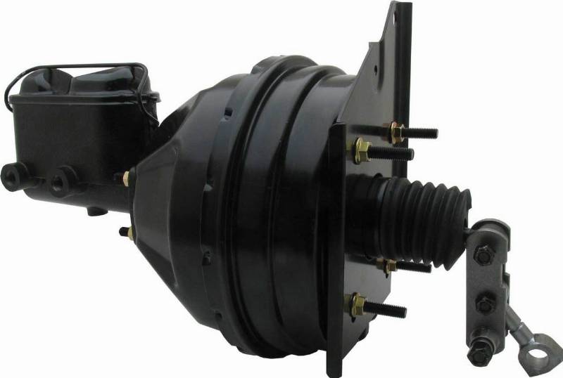

regarding pedal height.
The linkage at the rear of the the
booster is a bellcrank.The pedal
assembly sounds like it may not
be original to the car.
There are brackets available that
will allow for lowering of the pedal/
booster while still using the original
4 mounting bolts for the booster
mounting bracket. The piston rod
center hole will need to be elongated.
