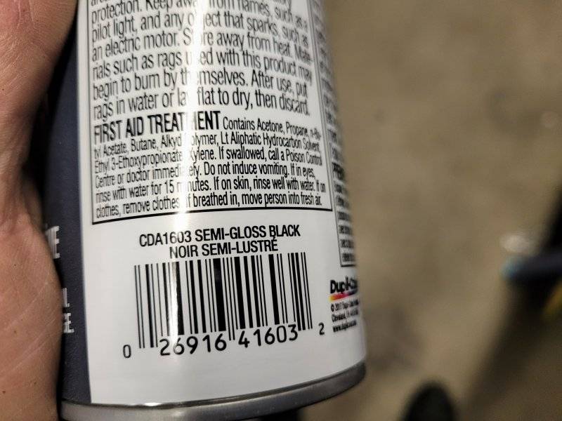

Depending on the part, usually a satin black or a gloss black applies. Or, for grey-metal color, there are several tints, example aluminum or cast-iron. You get the color to match the particular part. You can also check Eastwood for their paints.
I like Krylon Satin Black, if you are not looking for super glossy. I also like Krylon Dull Aluminum for detailing aluminium parts like alternator, transmission case, etc.

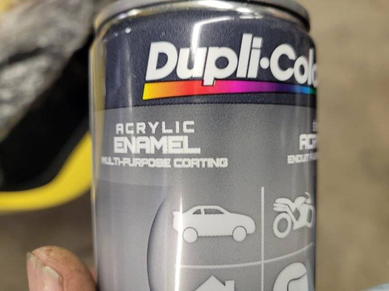

When ever I go into a store, I always check out the paint isle. When I do my restos, I'll use different manufactures blacks, silvers, cast, etc. No 2 shades or finish are ever the same. I think that it makes things look more "unique", like different black parts came from different vendors and so on. Dupli-Color makes 2 or 3 different black engine paints that I'll use on any part. Trouble is, paint prices up her are getting crazy. The last can of VHT Hemi Orange I bought cost me almost $29.00 out the door!

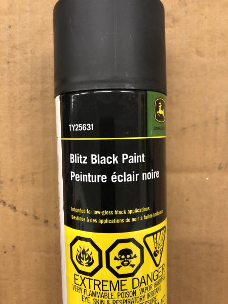

This what I use, very durable. Satin black, almost a semi gloss.
If that John Deere paint is like their either it’s dam good stuff! The have the best starting fluid on Gods green earth!

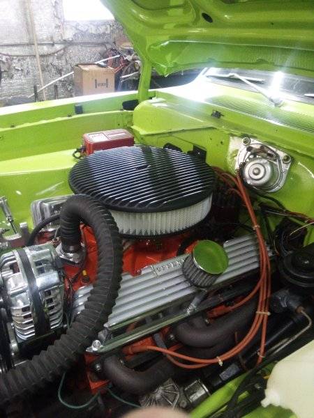

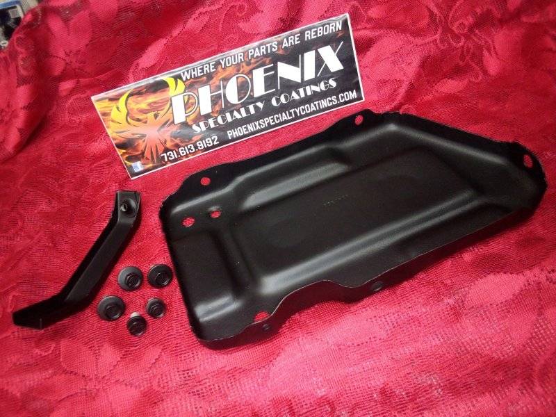

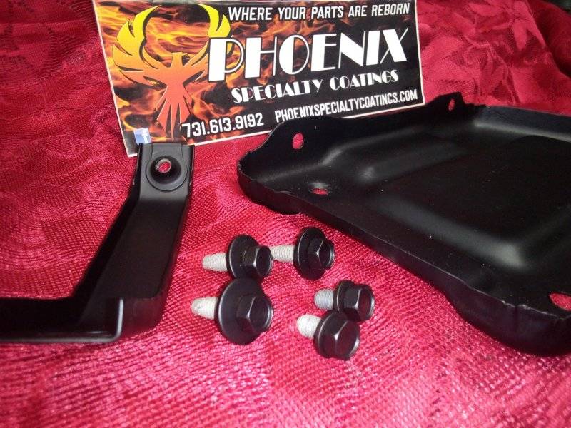

Billy used that on his Fury stuff that couldn't be coated. My Black Jack (on the battery box above) is an EXACT match for it.
I considered LimeLight for the box but there's a lot of it under the hood already, and the satin black powder matches a bunch of stuff I did in the distant past. Still need to get it out to coat all my fender bolts though lol ...
