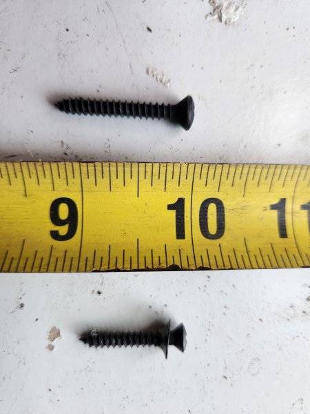

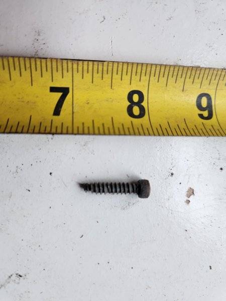

1st pic repops top is for radio bezel 2nd pic is original screw from my 70 charger. Gauge cluster also should have a clip on the frame for the screws. Hope this helps.

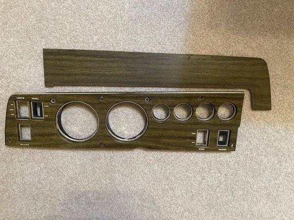

Would a 70 rallye dash wood grain have chrome fillister screws for the instrument cluster? Chrome screws for the radio bezel? What about the AC delete bezels, black or chrome? Thank you
All 70 rallye dash screws that attach woodgrain in your photos are painted black or finished in black. Fillister head for the instrument cluster only. Conical phillips head for the radio plate and two small end caps. Message me if you need more details. I can provide dimensions of the correct style screws. Joe

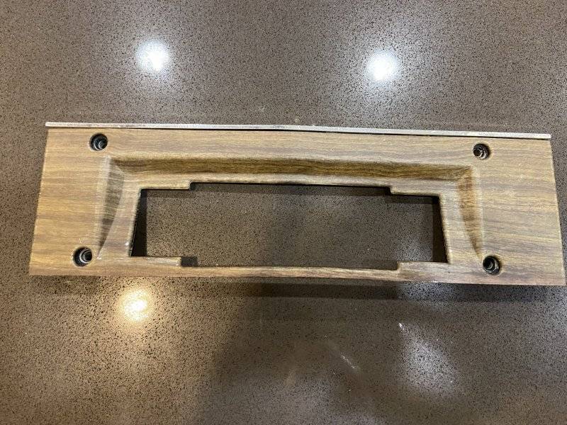

instead of me starting a new thread....
Can anyone tell me the size and type of screw for the radio mount? My best guess is 1/4 20...about half inch long. Also the size nut for the back. Is that a nylon ?
