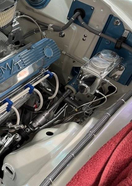

All I can say is both my 70 charger and Bee were bare metal,no paint.
I just polished the bare steel then clear coated it.
Elbow grease. :p
Tripoli compound then white rouge on a buffing wheel. The column was apart.
