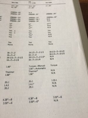

quick question. I’m going to replace my original 71 383 none ac water pump and I’ve seen a lot of water pumps online says fits big block Mopar’s but some have 8 blades and others have 6 blades. I haven’t removed it yet so I’m not sure what I needed.
I've been useing the eight blade and no cooling problems at all. Pully size can make some difference, pump housings have minor differences, ect. Some pumps have slightly different blade designs also.
If I were you, and you haven't had any cooling problems, I would replace it with exactly what you have now.

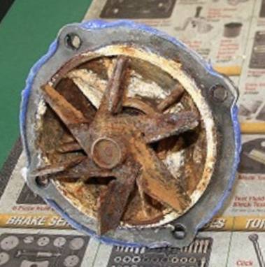

Just checked service manual the difference is non ac has 8 blades and ac 6. Last line in pic.
6 blade for ac since a smaller pulley is used, 8 for big pully. 8 on ac might give high speed cavitation

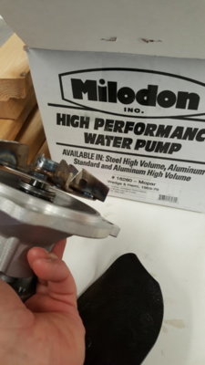

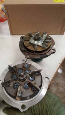

I had an 8 blade hv summit pump and it hardly flows at idle after the stat opens but flows well at higher rpms. I just changed it to a milodon hv pump with 6 blades which are longer. The flow at idle is much better.

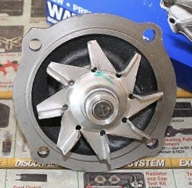

Majority of the aftermarket are 6 blade but fin shape is different and they have a plate welded to the back of the fins that none of the OEM have. I do belive this supposed to help increase flow. One thing I noticed is that I would say 80% of after market are identical with different names on them . I went Proform aluminum hI flow from summit advertised as "mopar authentic."
Another member posted up one that he got off rockauto for 30 bucks or something like that . It is IDENTICAL to the one I have and paid almsost 100 dollars more . If I had to do it again I would get one from my local napa that has 8 blades for 60 bucks .

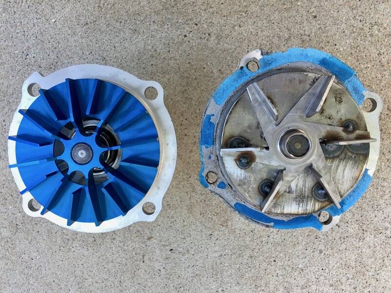

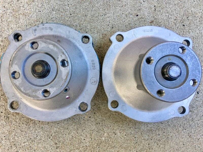

I took a $32 GMB (Japan) pump and welded the anti-cavitation plate on it. I also have a Flowkooler and it's the identical pump with their impeller on it. A little OT but I agree with KID if he has no other issues I would stick with what he's got.
