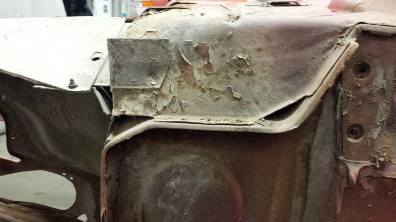

Here is a pic of the side drains. You can pull the cowl screens and reach in there with a shop vac. Then you can pull the plastic shields at the back of the fender well and reach the drains with an air nozzle.
