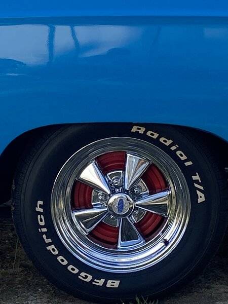

Thanks for the responses guys! The unilug uses the shank lug nut, runs through the wheel to contact base of wheel stud, so stock studs ok. I was just wondering if I'll have enough thread engagement with the direct drill with conical lung nuts which do not run though the wheel.

I ordered the correct acorn shank style lug nuts with the wheels. The shop I purchased the rims from hooked me up with the correct lugs so I wouldn’t have to change studs. The shank part of the lug nut give you plenty of threads on the original studs. A good wheel distribution center can get you the correct lug nuts.
