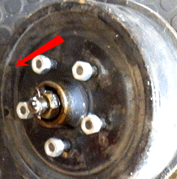

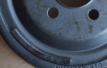

Just installed new Cragar SS wheels on my 65 Satellite with drum brakes.
First time I drove it, I had a nasty pulsation when I stepped on the brakes. The weights on the drums were touching the rim. Ground off about 3/16 from the weight. Problem solved.

I believe he's talking about the spot welded on balance weights that may be taller than the drum causing the Cragar spoke to not sit flush to the hub/drum assembly.......
Same issue with my 66 Dart. It's hard to believe a machined drum can be that off balance to require a 5+inch long balance weight. I drilled mine out and knocked them off, installed whe wheels and cruised on.

Why not just use a spacer instead of knocking the weight off ? Doesn’t that weight hood balance or something ?
