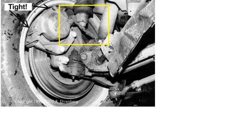

Ok, wondering if I should start a new thread, but this will probably work as well. I'm making progress on my tear down, and have all of the parts here or on order. Reading different opinions in regard to front or rear caliper mount on a 70 B Body is to put the caliper in the front, but looks possible in the rear as well. I'm planning on front. I got a 73 a body remain caliper that has the same connection location as in the Disc O Tech article and while the picture in the original article is decent enough, I was wondering if anyone just used stainless hoses vs the flex hose like in the article pic I highlighted? I got a stainless pair from Cass (DrDiff), but then I also found a hose from Autozone (should arrive tomorrow) that looks to be exactly like in the original article with the banjo/metal line from caliper and then flex hose.
Does anyone have a pics of a front mount conversion from the back view and how the hose is routed? Maybe I'm overthinking this.
Two more things, I've been wanting to do the C-Body Tie Rod end upgrade and have parts for that and also I have a Hellwig 55904 1 1/4 sway bar that came with the car. I've been thinking about doing both during this swap and it does not appear that front vs rear will make a difference? Thanks as always everyone!
Front-mount your calipers and save yourself some hassles. Stock lines will also remove guesswork.
