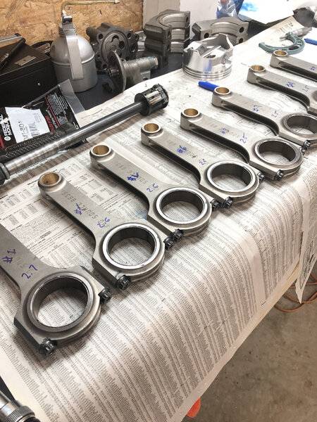

I put many hours today in to cleaning up the crank. I put a set of bearings in a rod and test fitted it on the journal. It fit looser than I would like. I have a digital calipers and measuring tools. Great time to use them.
The rod journal stock to the best of my knowledge should be 2.374". Mine measured 2.366".
The bearing clearance should be .001" per each 1" diameter of the journal. Comes out to .0023" bearing clearance for oiling, add that to the journal diameter, comes out to 2.368". 2.368" should be the measurement inside the bearing when tightened on the rod. Mine measure 2.373". .005" too loose. They are sloppy.
These bearings were with the crank. They should have been the right ones. But I dont think so. Do I have it right or am I screwed up?
You can’t accurately measure bearing clearance with calipers. You have to have a mic and a bore gauge. I was a machinist and am damn good with calipers but would not trust them for that type of measurement. Platigauge would be better in that case. You could also get much closer with a snap gauge and mic.
