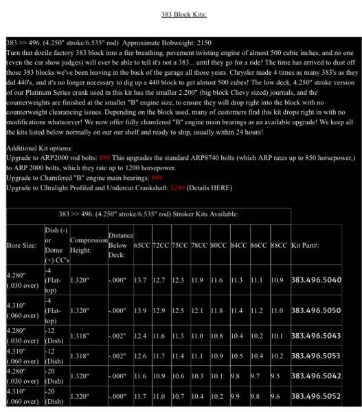

The old way was to offset grind the rods to take a big block Chevy rod and then have custom pistons made. 440 Source has all the stroker information on their site. They put together complete rotating assembly kits that will mostly just drop in...

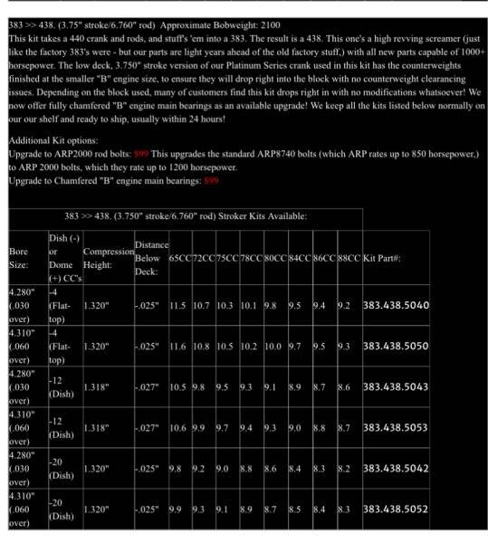

It looks like 440 source makes a rod and piston combo for stock rod journal and 3.75 stroke?
Stroker Kits-store.440source.com
If you want to make sure everything is compatible; go with a 440 source balanced kit with 438” or 496”
