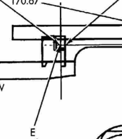

FWIW, You might enlarge those drawings so you're sure where the arrow heads point...………

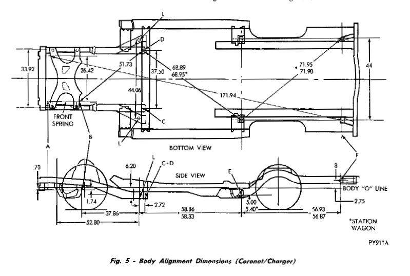

The manuals came but it only shows satellite wagon specs and nothing for 2drs. Are they the same basic chassis and wheelbase?
71 service manual pg 238 go to my mopar 1971 body service manual. click the link in my last post.
It says station wagon on what you posted too. I assume they are saying wagon and other Satellites are the same wheelbase and the same structure.
Note the asterisk near station wagon, don't known what it means. You really need to download the body manual to read it. If you only have phone it would be impossible to read. Just having dimensions doesn't help unless you do frame work I guess.
It's the same diagram in the manuals I just bought and also says station wagon.
All I can say go under the undamaged part of your and see if measurements match up. If not the search continues .
Note the asterisk near station wagon, don't known what it means...……...
Not totally sure but I'm thinking that asterisk (*) along with two dimensions, with the asterisks typically being high on the typed line, then just lower would be the referenced dimension. By that it would appear the shorter 58.33 to be the wagon dimension...…….
........I assume they are saying wagon and other Satellites are the same wheelbase and the same structure.
I don't know that wheelbase has to be the same as spring and perch lengths can change.
From the '71 Hamtramck Historical wheelbase dims......
